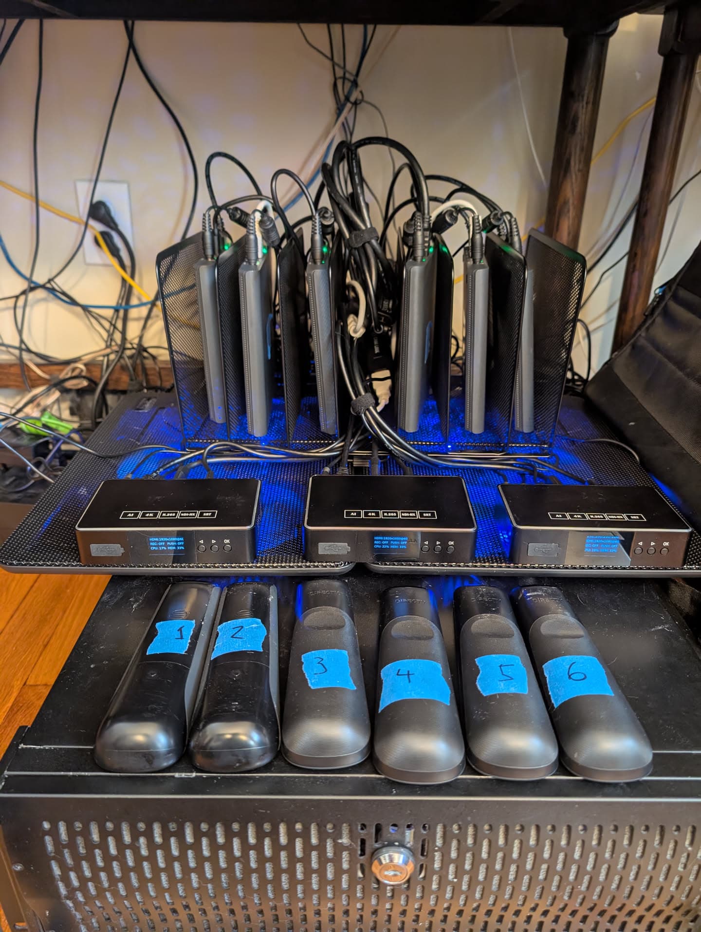

Switch them Osprey's to POE with 1’ HDMI cables and you’ll be looking clean!!

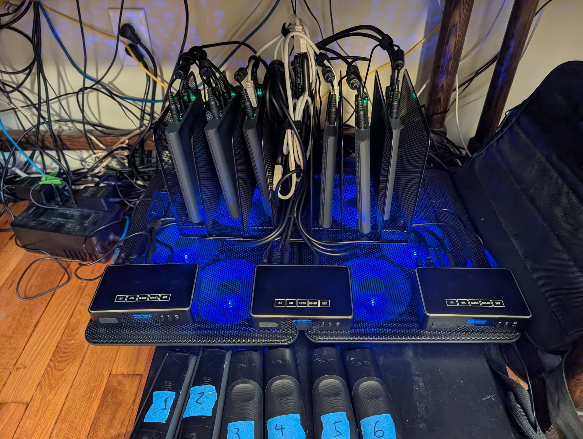

I looked at something very similar. It was bigger than I needed for my little onn 4k boxes. I eventually abandoned my taco holders and suspended my tuners from a PVC frame.
I like the cooling pads underneath. I should do that under my little setup. Do you mind sharing which pads you use and why you chose those specific items?
Awesome! The Taco Tray Trend continues!

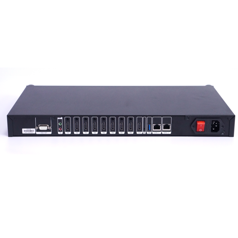

I am about to embark on using the LinkPi with ONN boxes and I have a question about picture quality. i.e. has anyone done a careful comparison of the picture quality between the output direct from the streaming box to the TV and the output from the stream as captured and encoded by the LinkPi. Do you see any picture degradation after going through the HDMI capture/encode then redisplay of the captured stream?
I haven't made that direct comparison. To me, I don't see much (any?) difference between my TVE and LinkPi recordings. However, I will say that I had video stuttering issues when I tried to push too much at once through my LinkPi. I'm running three onn 4k boxes and three Roku 4k streaming sticks into a LinkPi ENC5-V2. After making some minor adjustments to framerate for all my tuners, I'm quite happy with the picture quality.
Yeah, on the ENC5 with six 1080p tuners, I'm maxed out around 45 fps. It handled 5 tuners at 60 fps with no problems.
