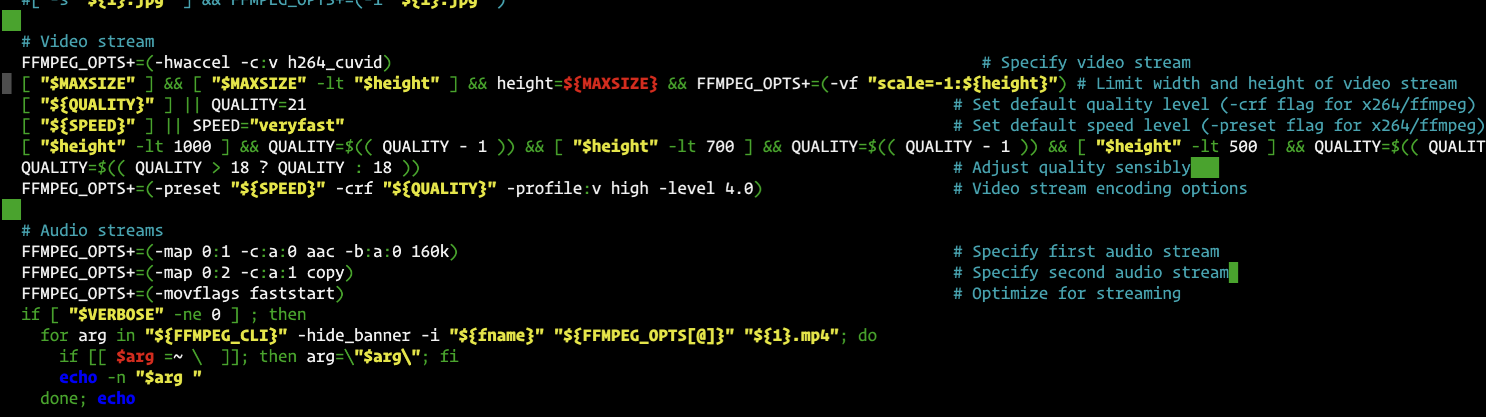

Anyone get this to work with HW yet? I tried editing the code, but was unsuccessful as I don't fully understand.
Option hwaccel (use HW accelerated decoding) cannot be applied to output url h264_cuvid -- you are trying to apply an input option to an output file or vice versa. Move this option before the file it belongs to.
Error parsing options for output file h264_cuvid.
Error opening output files: Invalid argument
Option profile:v (set profile) cannot be applied to input url 243.ffmeta -- you are trying to apply an input option to an output file or vice versa. Move this option before the file it belongs to.
Error parsing options for input file 243.ffmeta.
Error opening input files: Invalid argument```
The position of the arguments to ffmpeg is important. In this case you must add the hardware related options after -i
This the code looks like -i comes before the FFMPEG variables?
-hwaccel -c:v h264_cuvid is not correct.
hwaccel takes a value and you're not providing one. And I think you probably want to use h264_nvenc instead.
