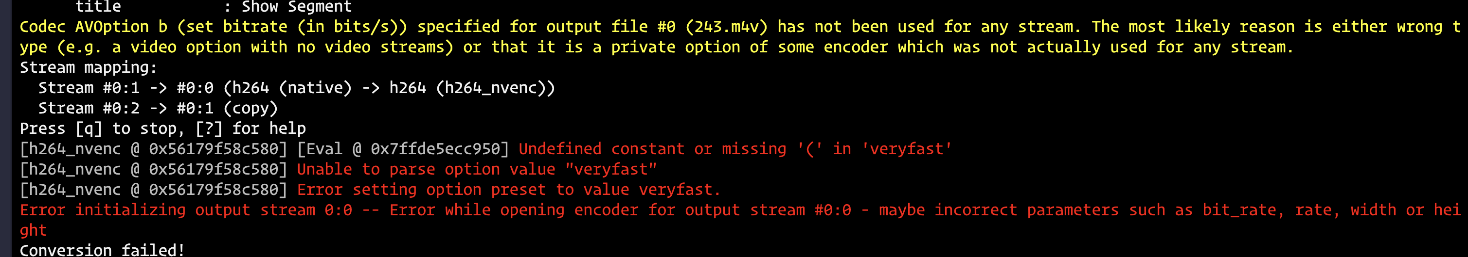

Got further with that now something is failing to map
Original line was:
You're still passing in options that only apply to the software encoder, such as -preset verfast
Hmmm. I think I'm going to drop it. Too much code to read through
