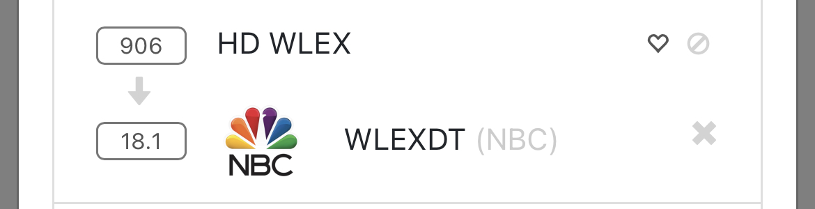

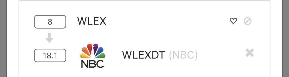

Are channels 8 (WLEX) and 906 (HD WLEX) actually mapped to the same guide data? If the "HD WLEX" is named/mapped differently, that could be why it was not tried as a replacement for the other two attempts.
Yes, they are both mapped to 18.1:
