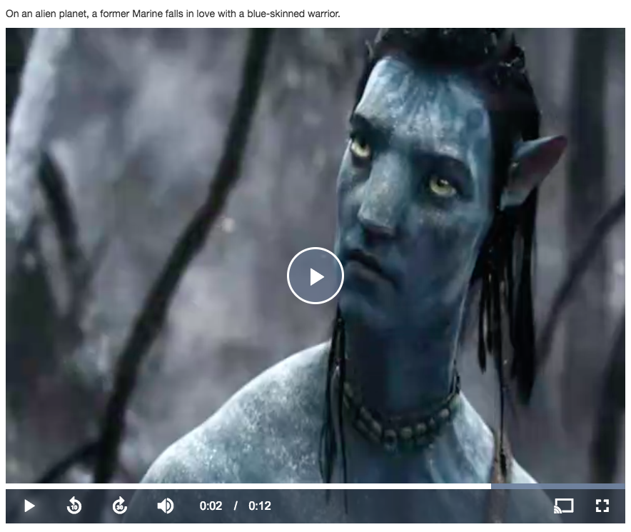

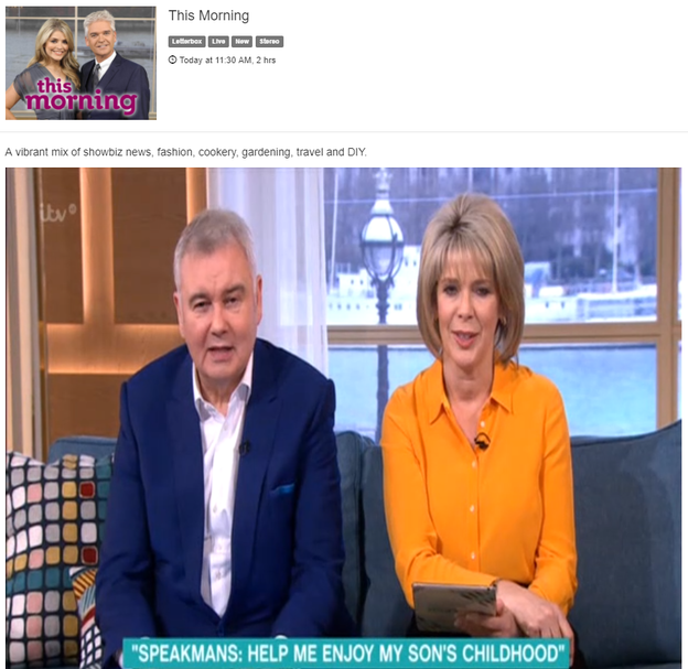

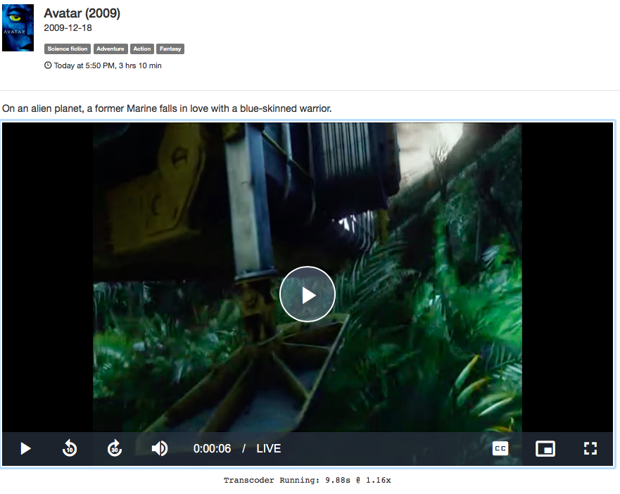

Probably easier to show you some screen shots, this is using Chrome & Safari on a mac, same channel a few minutes apart
Chrome:-
Safari:-
Thanks. I finally got my Windows machine up and running after spending all day yesterday updating it. I was able to reproduce this issue and fix it for the next build.
