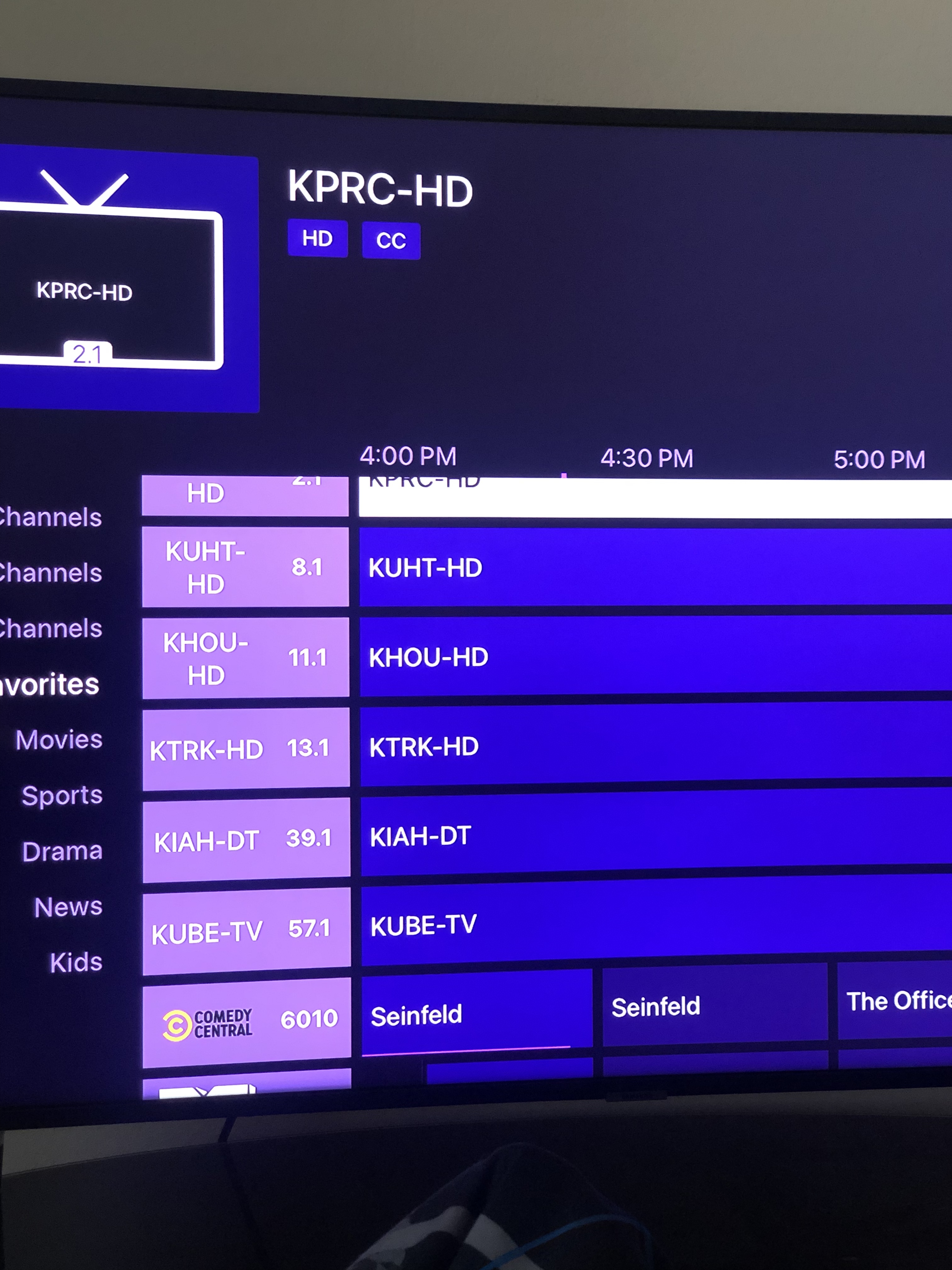

Local channels issue
No guide name on local channels shown, but if channels DVR is disabled (by logging out), then it shows.
Most likely that means you have not assigned guide data to your HDHR tuner in the DVR's web UI. You need to give it a ZIP code so it can get the guide data for your stations in the DVR.
Works thank you!
