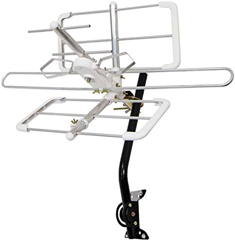

Which OTA are you using? My NAS and router are in a closet and I need to find a decent OTA for local channels, since I’m thinking about getting rid of FIOS TV
HDHomeRun
I get it - but which antenna are you using? and it is placed by a window somewhere?
In the attic. about 20-25 miles from antennas in 2 different locations.
Post results from https://rabbitears.info/searchmap.php (it should give an anonymous link) . OTA is highly local.
