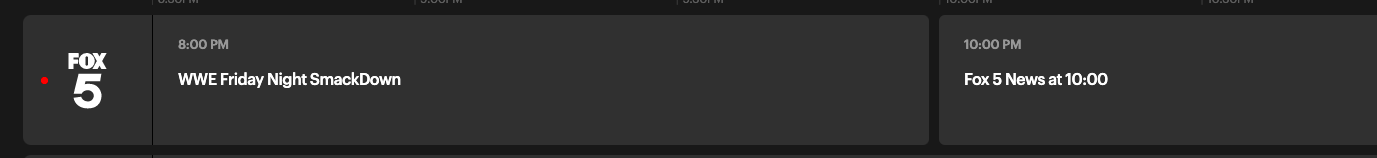

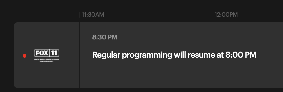

Can you post a screenshot of fox.com/live after navigating the guide to tomorrow afternoon?
If it looks like this, then the channel doesn't have a 24/7 stream and won't work:
Ah, I could swear I saw a lineup, but now shows as you noted. Guess time to hook up the antenna, thanks!
I'm in the same boat I think. I was also using Locast. I rescanned my Directv credentials and found the networks, but Fox is acting weird. The guide data isn't correct - the Ohio State game is on right now, but the guide is blank until 11:00. If I manually tune to the channel, the game is on. I navigated to fox.com/live and the guide data looks like it has a 24/7 stream.
