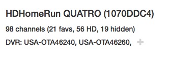

I've added the Zip for the tower location 46260 (5 miles or less from my location 46240)

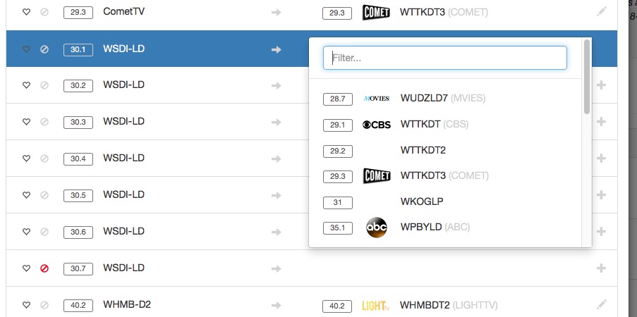

I then went to the plus next to 30.1, and it does not show any available mappings
01%20PM
Try zipcode 46268, that’s where the tower is located.

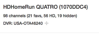

I hope it sticks. Subsequent editing of the HDHomeRun QUATRO only shows my home ZIP listed and not the added ones.
