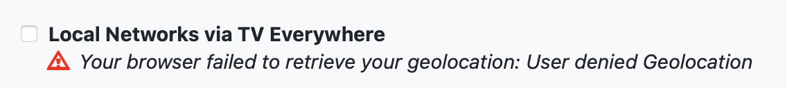

No matter what I do I keep getting this error when I try to enable Local Networks via TVE.
Try again over HTTPS here or here. Your browser failed to retrieve your geolocation: Origin does not have permission to use Geolocation service

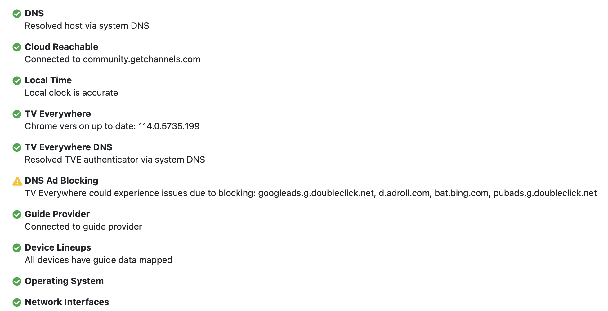

  • I also run a pihole server that keeps my network clean of ads.

And you should whitelist your DVR server in your pihole setup.
Thanks. I did click both links and I still get this:
Your browser should prompt you to allow it, unless you set it to never allow.
I said "yes" and it still doesn't works. I've tried on different machines.
I found the issue: It was setting in the System Settings (on the Mac) to allow access to the location for the browser. There is a site setting in the browser that was already set to "ok", but had no effect since the whole browser was denied.
