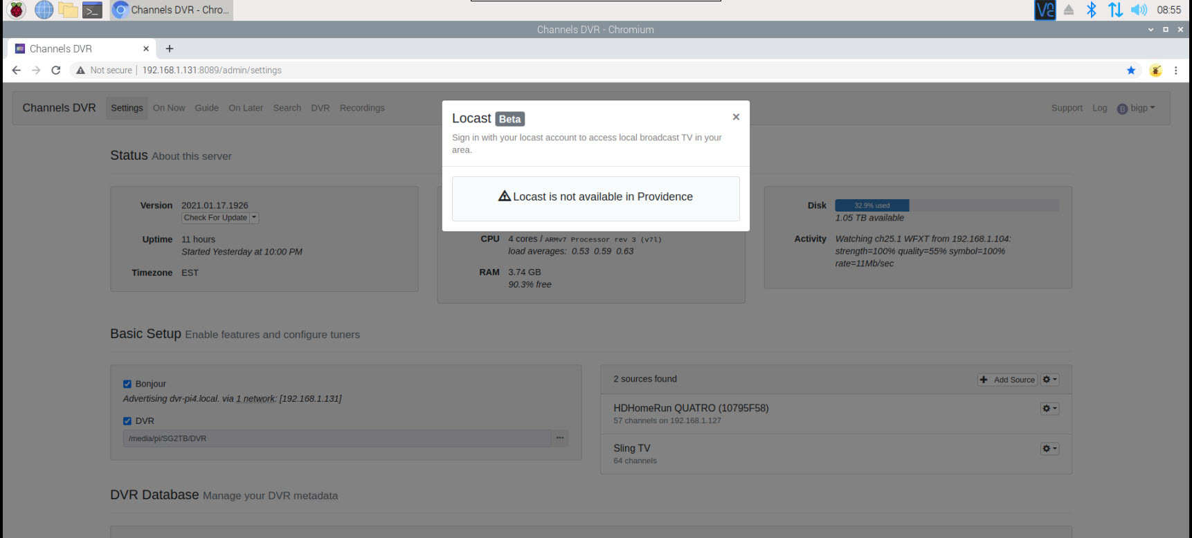

Been using Locast with Channels on my PI4 flawlessly for the last 6 months. As of sunday locast crashed and said invalid location and that the http was disabled for location services. I have confirmed that location is enabled, and i can log in fine from my PC/android, firestick phones. everything except my PI4 and also trided on my Pi3 with same results. Also, downloaded Channels Pi4 image to try and had same issue. seems to be with chromium? Anyone else seeing this issue? I have tried pretty much everything i know. Any suggestions will be appreciated.

What is the exact error message you're seeing and where is it shown? Please copy/paste or take a screenshot.

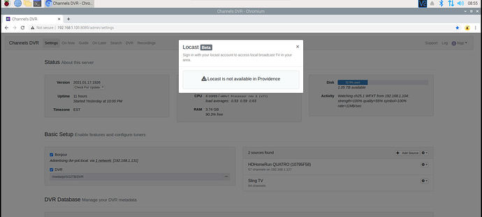

So, with channels when adding it shows a random location outside of Boston MA where my ISP is located. if i open locast.org in chromium, i get location like Providence or Hampton not in the locast area.

Try https://192.168.1.131:8089 you will need to click through advanced and get past the security warning.
So I can access settings that way, that is how i always have done it. even there for some reason when adding locast, it displays a completely different location. really strange as it has been working great for at least 6 months now. may need to move to a mini PC instead of the PI

I'm asking you to use the link above (with HTTPS not HTTP) and try adding Locast using that url.
