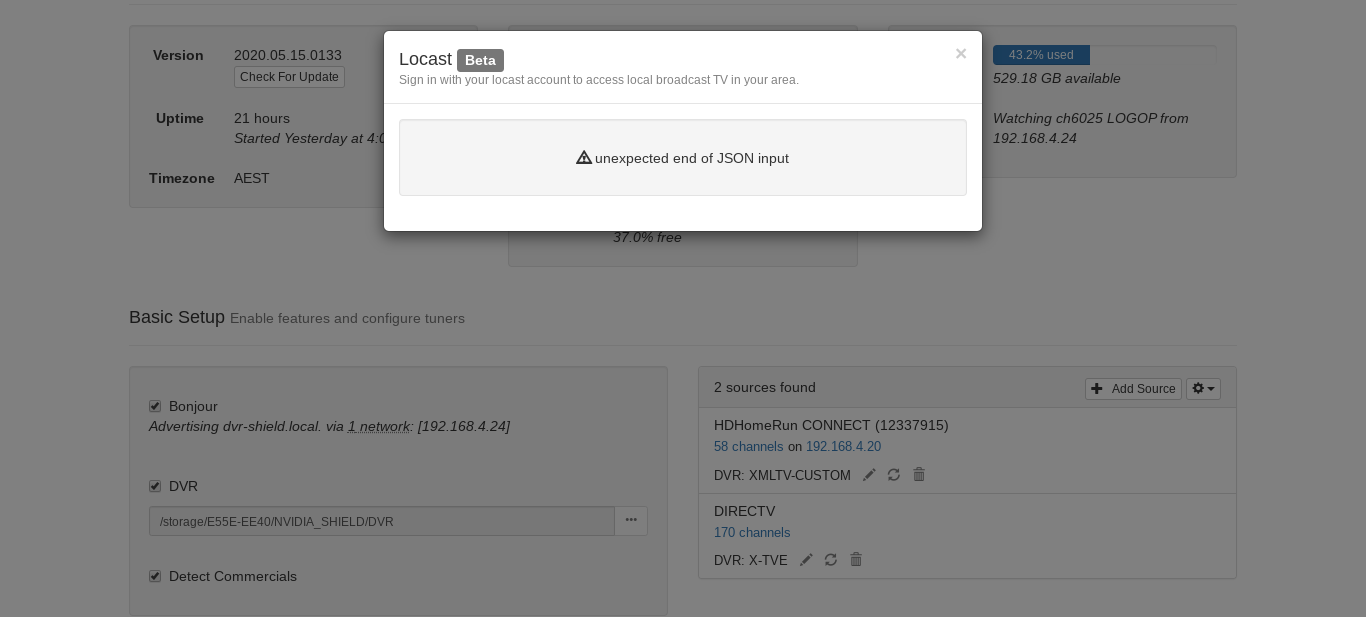

When trying to add locast i get "unexpected end of JSON input".

Could you take a screenshot of the error? I'm not seeing anything in the logs so we may need to improve logging somewhere...

Didn't know Australia had Locast service?
Are you using a VPN or similar service? The screenshot seems to indicate you're in AU.
If so, this is probably the cause of your issues. Locast is geo-restricted to only certain select US media markets.
In the latest DVR pre-release I've made a small improvement to the error message to help us track down which request is failing with this so we can provide a more informative error message.
Thanks Eric still no luck
Can you provide a screenshot of the error message?
