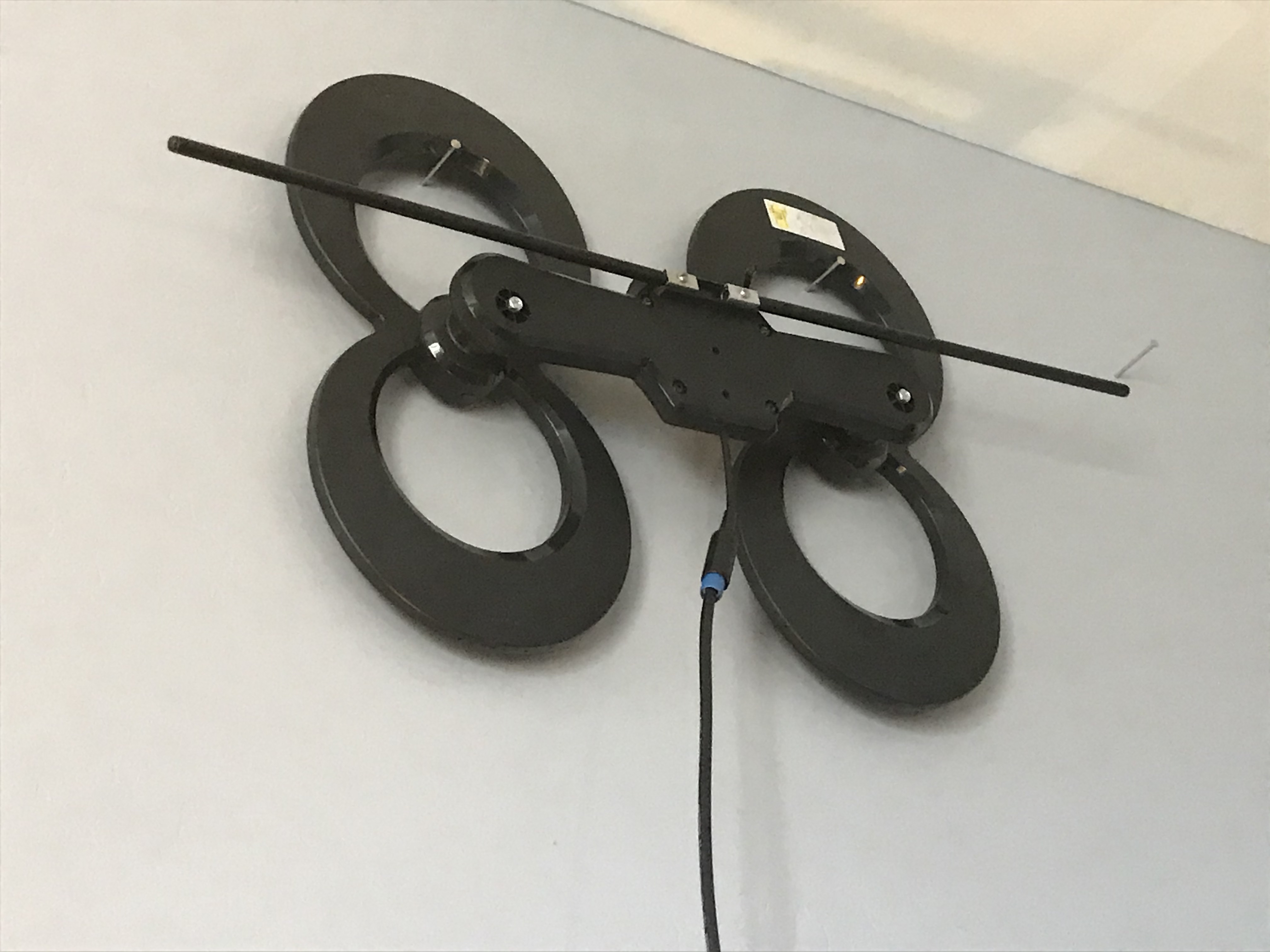

Thanks for the above. I don't have easy access to the roof and we don't have an attic, so I have my antenna hanging from one of my walls indoors facing the broadcast tower. I took me a LONG time to position it to get most of the channels but I had to sacrifice a few--but those are channels I barely watch but would be good to pick up. I guess I could do a hybrid, right...antenna for those I can pick up and Locast for the rest?

That must get channel 88 the best I would imagine.

The joke was the antenna looks like an 88.
Ah ha. Boy, am I dense.
