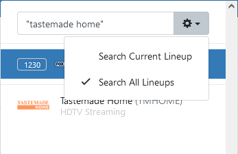

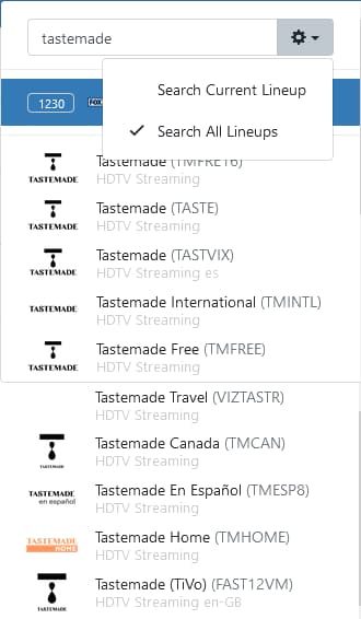

  2. alternatively, you can leave the EPG portion blank and map each channel in channel lineup.
    When searching, choose all channel lineups.
    The Gracenote stuff from channels looks and works great on the guide.

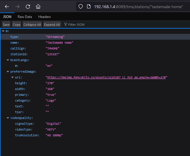

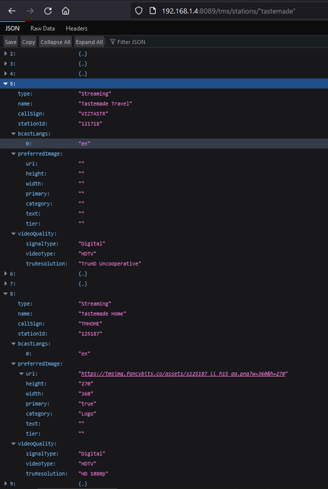

(Since DirecTV offers both channels, and they also use Gracenote for guide data the same as Channels, one could make a likely inference that Gracenote has data for those channels. However, I only offer the news that you can likely get the data from Channels for better integration ... but I don't know the specific TMSIDs to supply for the tvc-guide-stationid tags for the XMLTV for your IPTV provider.)

I've been manually mapping the channels and don't mind doing that - just haven't figured out how to search properly for those 2...
Look at the images I pasted it has the Callsigns.

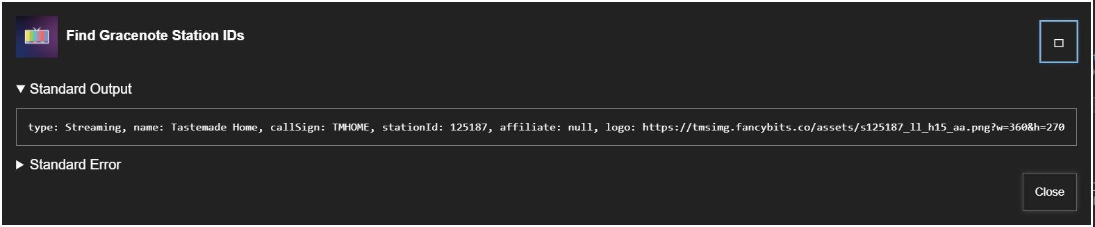

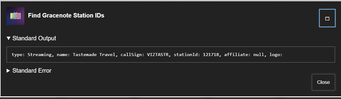

That worked perfectly (using the full callsign). Is there an easy way to search Gracenote for them? I know you mentioned OliveTin?
If you don't have OliveTin, look at @chDVRuser's post right above yours. :wink:
OliveTin uses the same "specific phrase" search as these below, where the search term is enclosed in double quote marks and searches gracenote stations
