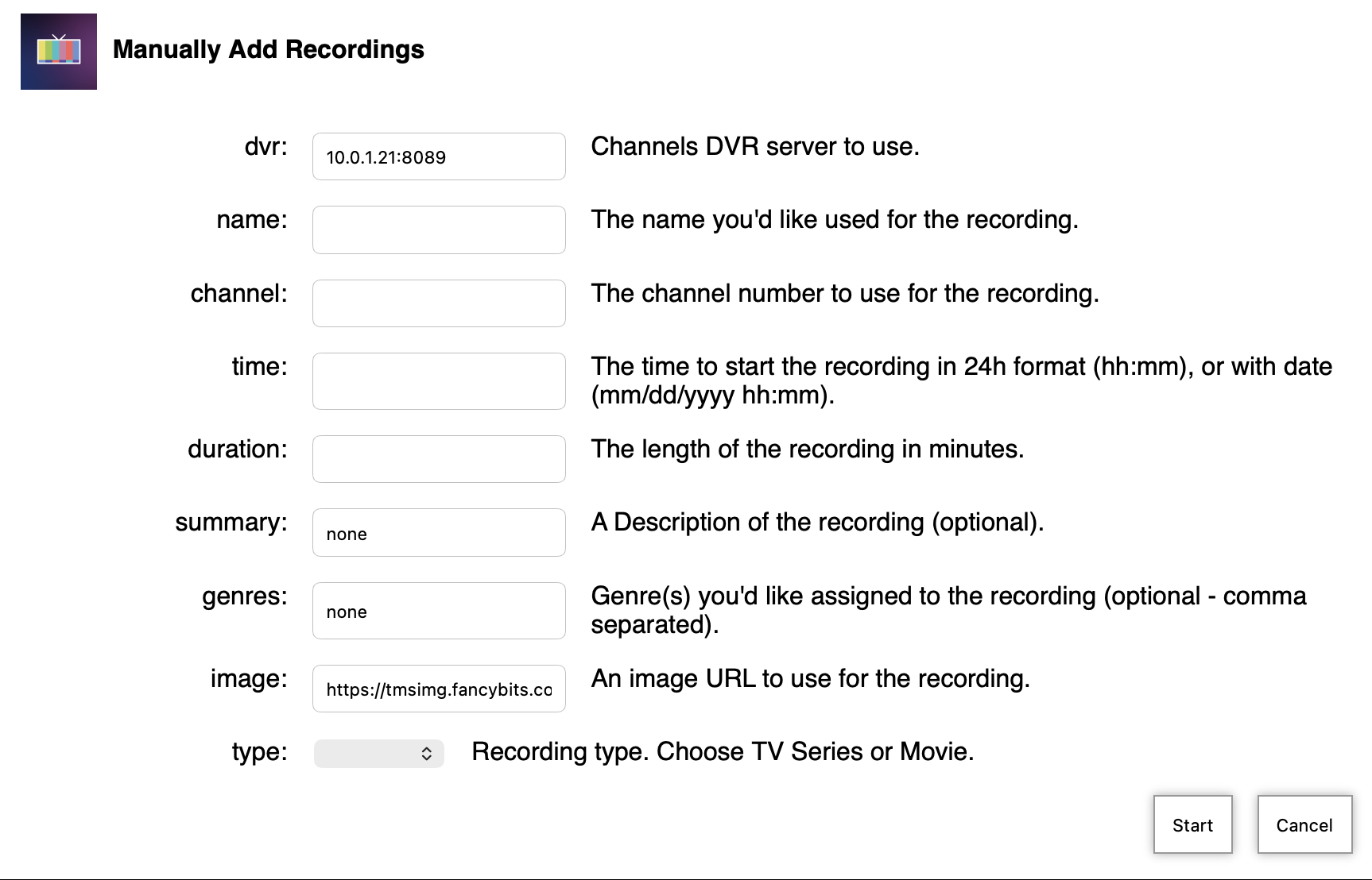

OliveTin is one option, but there is also this Chrome extension that reportedly works well.

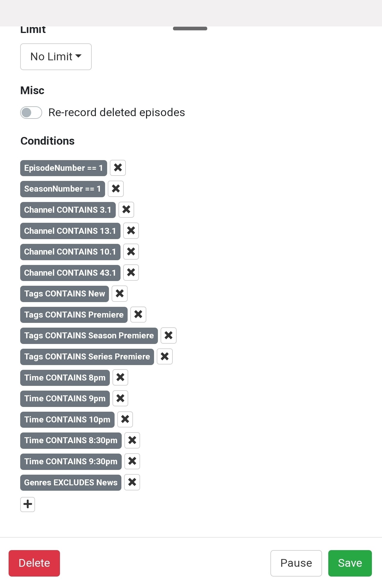

I understand what you are trying to do however, I think there is a much more elgegant way to do this. What I did was to create an advanced pass to record all series premieres on the 4 big networks (ABC, CBS, NBC, & FOX). See my screenshot. Basically I used a combination of air times, channel numbers, and tags to make this happen. You would obviously need to tweak channel numbers but this shoud allow you to get all new content without having to think about it. When you find a show that you want to continue to record you just create a pass for that show since this pass is limited to only episodes that meet the S01E01 criteria. Once you do that all subsequent episodes for that series will record as well.
Those are great tools, but they can only help to create a manual one-off recording, not a recurring one, like the OP asked for.
That gives me an idea to improve my extension to enable recurring recordings.
Added to my list of future improvements.
Check out the Advanced Passes section in this forum
Thank you, I set up this rule
I think you will be pleased. We find new shows to watch this way and quickly delete the stupid ones lol. Just dont forget to create a pass for the individual shows that you record beyond S01E01
