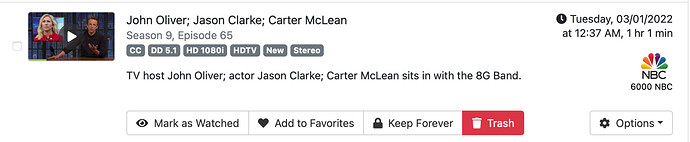

Not completely sure how to describe this but on NBC Late Night with Seth Myers and the Tonight Show I'm getting audio dropouts during certain segments. The audio is fine normally like during the into and when Seth is talking. But when he plays a clip, the clip audio almost completely drops out. I can raise the volume way up and can barely hear the clip audio. Then when Seth starts talking, volume is back to normal. I thought this was an AppleTV thing or something with my sound system but I can reproduce this with the web player.
Nothing shows in the logs. I'm running DVR server version 2022.03.10.0231. Also this was recorded from YTTV so maybe this is a TVE issue or a NBC. Playing the same episode with the YTTV AppleTV app the audio sounds fine throughout with no dropout during the segments.
