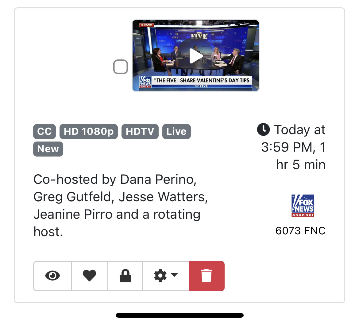

Was recording “The Five” during this time. Recording shows as interrupted, which can be seen in the logs; but the recording has not demonstrated the Lost Connections.
I'll reboot the routers later tonight after all scheduled recordings are done.
