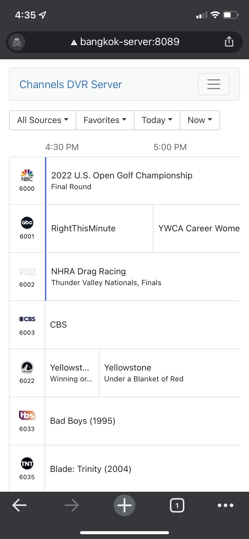

I’m in Cincinnati and can watch CBS via the link above. It tunes into WKRC. But in channels, I’m only able to stream CBS - no guide data and no ability to record on account of the lack of guide data. Any way to solve this, or am I just out of luck?

Yeah, I can stream WKRC in Channels. It’s mapped with the channel logo. I just have any empty guide for the channel. When football season comes around, for example, I won’t be able to record games on CBS.

You can also post a screenshot like I did above showing the guide mapping for your CBS channel 6003 and a screenshot of the grid guide from the dvr web UI showing the listing for CBS channel 6003.
