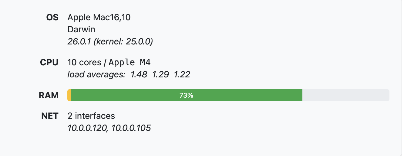

What does it show in your DVR web UI under Settings > Status for its IP addresses.
Screenshot 2025-10-15 193726

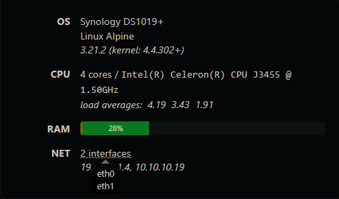

Hover your mouse pointer over "2 interfaces" to see which network adapters they are.

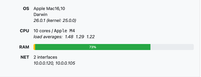

Screenshot 2025-10-15 193726-2
My guess is you have WiFi enabled.
Channels DVR will listen on all your network interfaces and that may be the problem.
Either that or because you're using IPv6.

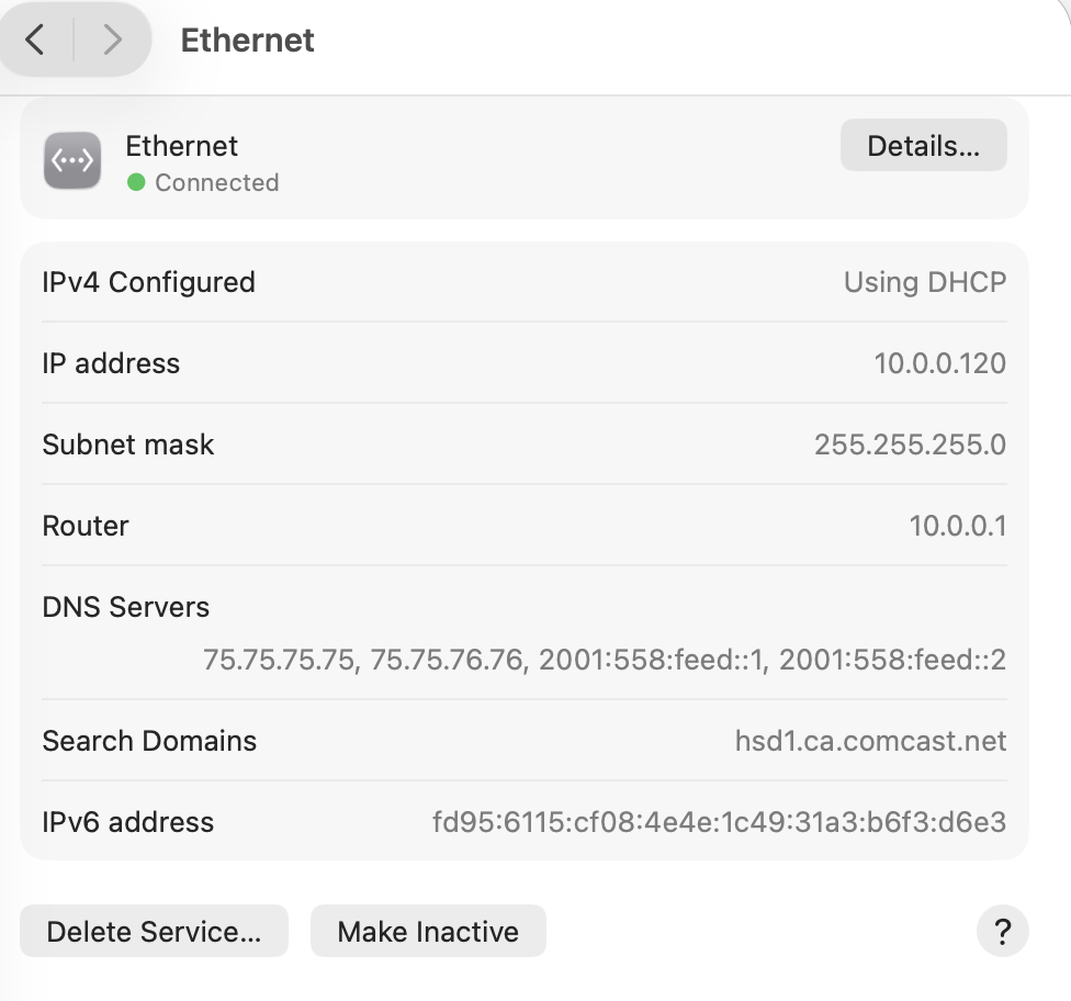

These are my network settings

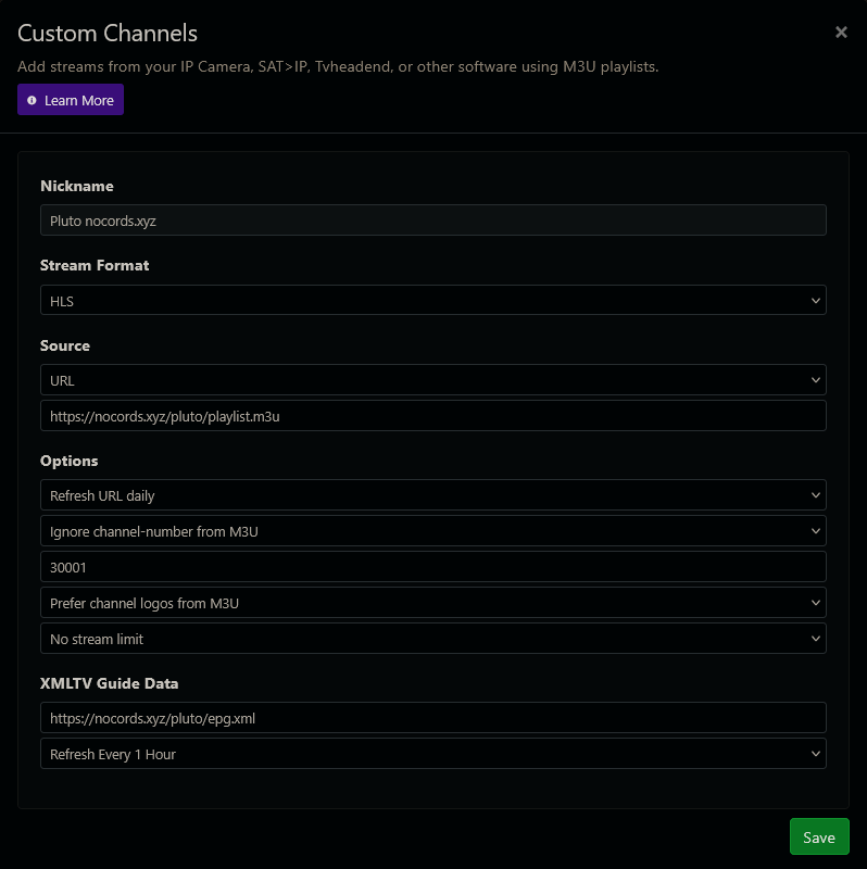

Can you open this in your browser?
https://nocords.xyz/pluto/playlist.m3u

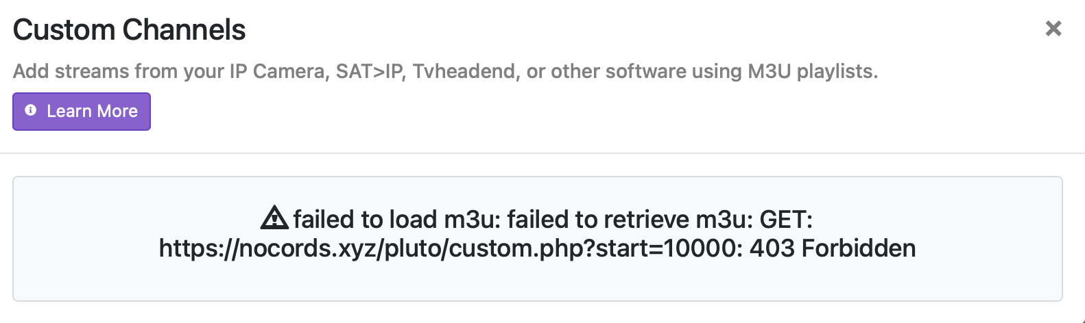

Just switched from AT&T Fiber to Lumos (T-Mobile) and noticed I am getting this - failed to load m3u: failed to retrieve m3u: GET: https://nocords.xyz/pluto/playlist.m3u: 403 Forbidden. Have updated Channels and restarted M4 Mini along the Channels DVR.
Can you get to that site through a browser? Double check the providers DNS settings on your router. Perhaps try changing them to Google's primary public DNS servers which are 8.8.8.8 and 8.8.4.4 for IPv4 and see if that makes a difference.
