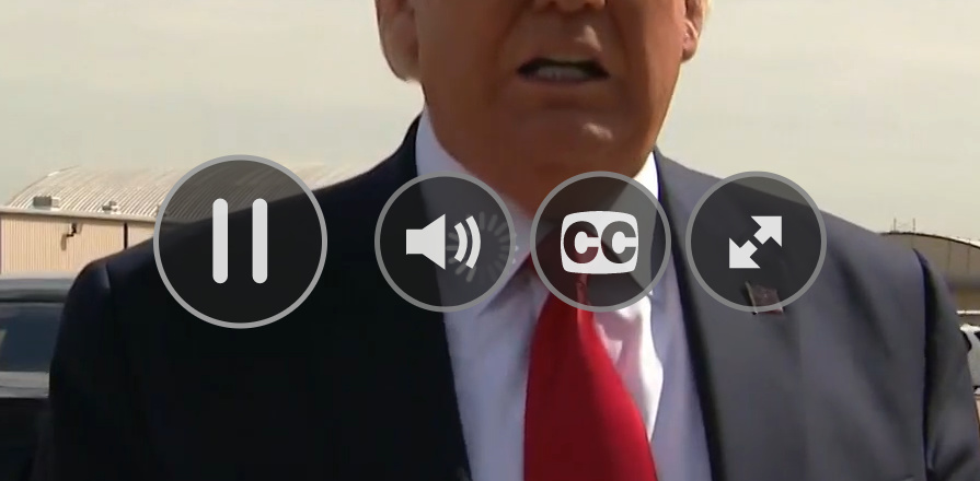

I just tried the website and it's pausing on there too. It shows a spinning disk for about 40 seconds during the pause(hiding behind the speaker icon)
