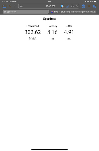

Seeing a ton stuttering as well since updating to tvOS15. I ran a speed test and the numbers seem good:
When I use Show Stats feature, the cache seems to run out quickly and the connection stat next to that field is typically in the low single digits: 1-3mbps

Other than your screenshot, you have offered no other relevant details. You have an Apple TV on tvOS 15, but is it wired? Wireless? What is your network topology? Is this the only device with issues? Is your DVR up-to-date? Clients? TestFlight versions? Is "stuttering" your only issue? Which types of sources are you seeing this with? All sources? Only OTA? Was this immediately after your upgrade, or was there a period where quality was good after the upgrade to tvOS 15?
The crickets are chirping because they're waiting. If you want detailed help, you need to provide details about your issues. Troubleshooting is an interactive process, and those on the other side aren't clairvoyant; they only know what you tell them.
