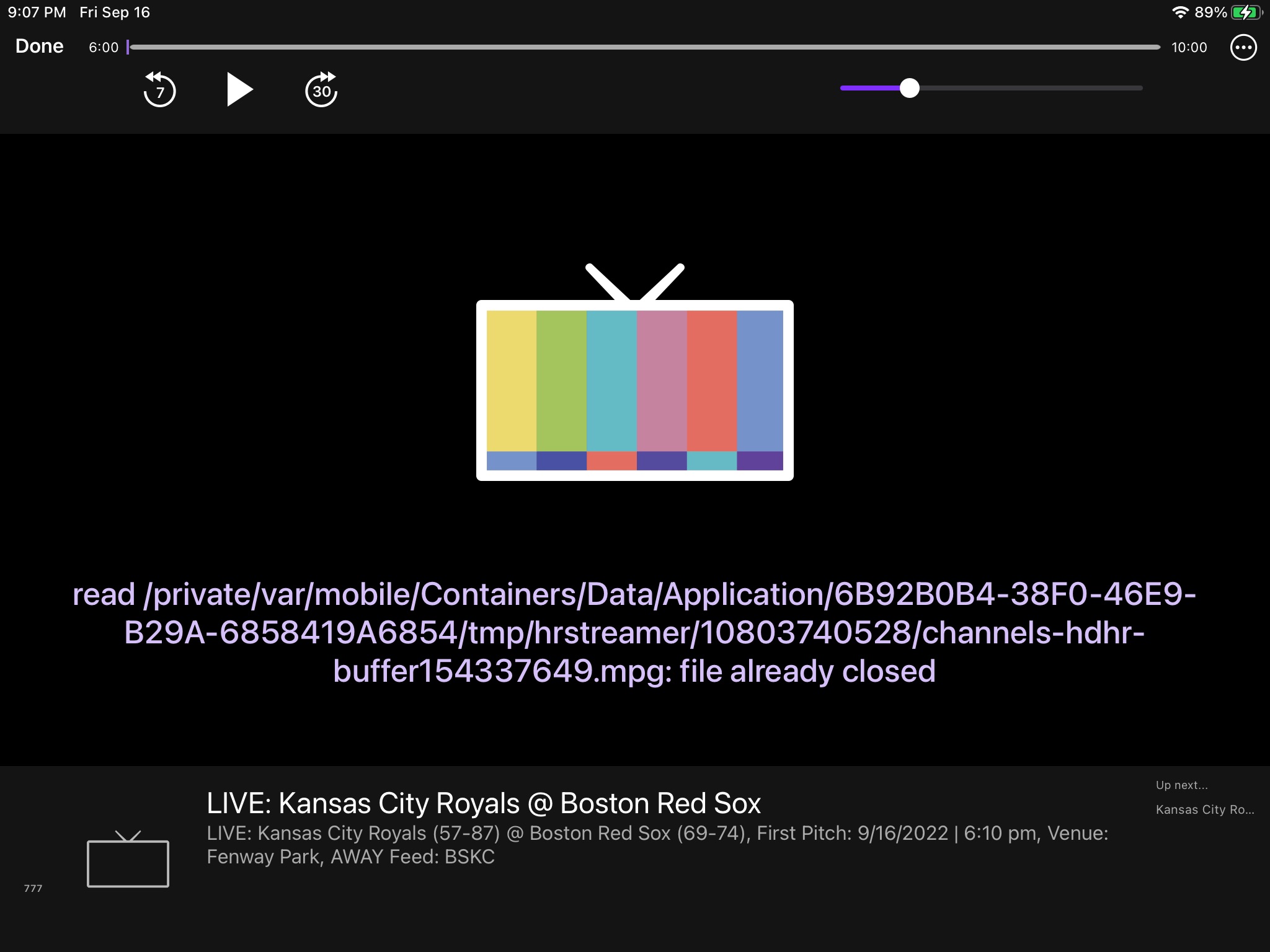

Dont know if this helps but here is a screenshot from iPad app when it was failing
I believe that error is unrelated to the underlying issue, but I've made a change to try to suppress that error to help us figure out what is really going on. Thanks for the screenshot.
