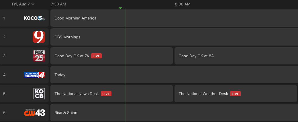

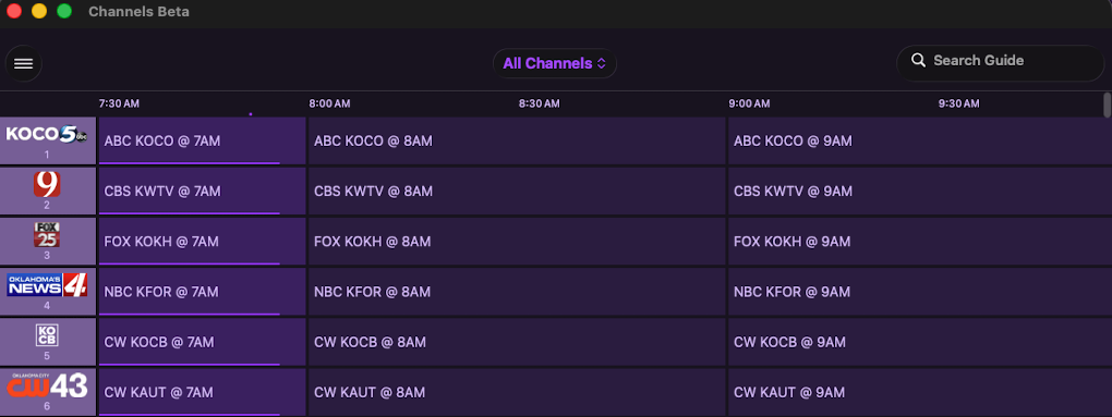

I'm supplying live TV from Dispatcharr into Channels DVR using an M3U link. I noticed yesterday that my guide information is no longer present. I downloaded the guide data directly using the M3U link, and all of the information is present. I'm also supplying live TV from the same Dispatcharr instance into Emby, and the guide data is present there.
I believe this started after updating to a more recent Channels DVR Server beta version. Is anyone else seeing the same issue, or does anyone know how to resolve it?

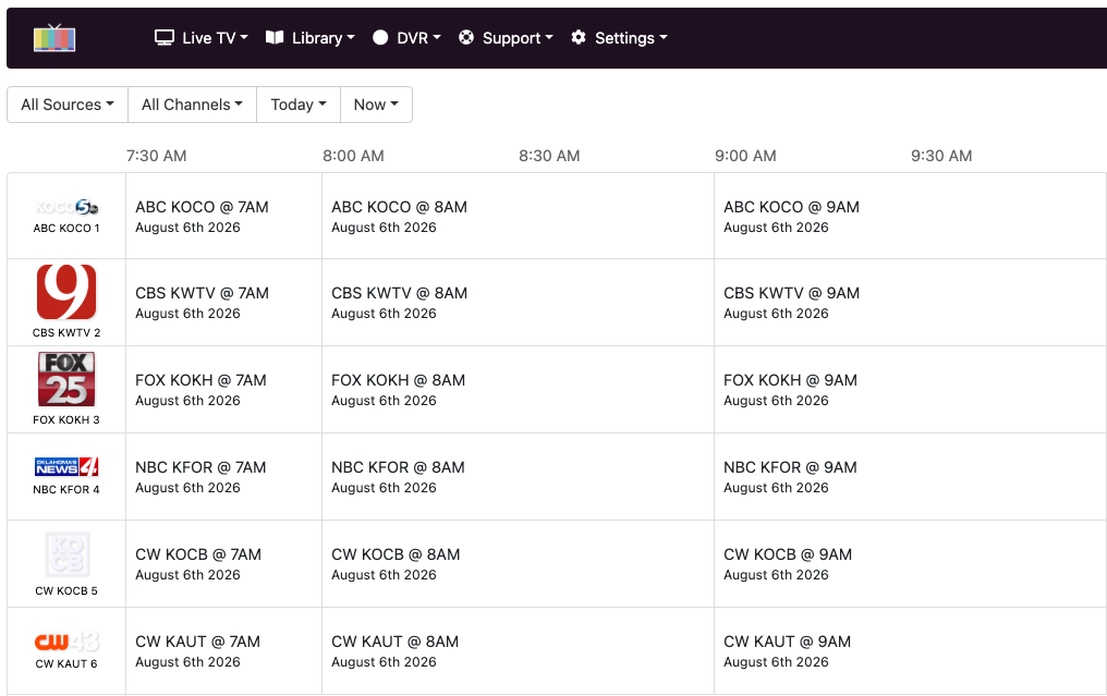

CDVR Guide
Emby Guide
CDVR Beta App

The issue was on my end. Below is what the developer found. After a few quick changes on my end, all was back to normal.
Supports Reply:
We took a look at your XMLTV file, and the issue is that its channel ids don't match the tvg-ids in your M3U.
Your M3U identifies channels by their guide data id, e.g. tvg-id="10614" for ABC KOCO. But your XMLTV file declares that channel as <channel id="1"> (the channel number), and its guide entries as <programme channel="1">. Channels DVR maps guide data by matching the M3U tvg-id against the XMLTV channel id, so none of those channels match and they fall back to placeholder guide entries.
To make the mapping work, the two files need to agree โ€” either:
  • the XMLTV <channel id> should be the same value as the M3U's tvg-id (e.g. 10614), or
  • the M3U's tvg-id should be the channel number to match the XMLTV (it looks like your M3U URL uses a custom Dispatcharr output profile, which may be why they differ)
Your 24/7 channels still work because their tvg-id happens to be the channel number, which matches the XMLTV. The rest of the guide data is all present in your XMLTV โ€” it's just keyed by ids Channels can't associate with your M3U channels.
