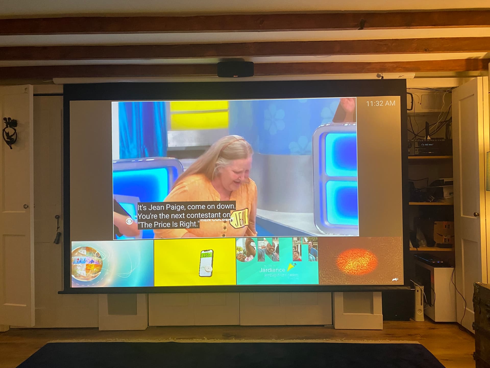

Update success #2: I did eventually have a signal cut out on me with the new cables to the NAS, but it lasted a lot longer than previous attempts.
So I decided to relocate everything over to a local drive on the server. It’s not a lot of space but I have extra failover drives including externals. I’d still like to eventually use the NAS as storage but I feel the cache should at least be localized if the devs can implement this.
Ever since having everything local, the IPTV channels are coming in fine. In fact, so far I’m seeing far less hiccups and buffering on this setup than I do with my Tivimate on my shield pro which I wasn’t at all expecting to see. I thought the previous hiccups on tivimate for the past few months was mostly due to iptv server lag but I may have been wrong all along.
Anyways will continue to monitor it. I’m disappointed that my NAS even on a 2.5gb connection acts intermittently. Not sure if this has anything to do with flow rate, maybe I’d need to specify a wins address, etc. I’m open to networking suggestions/practices.
