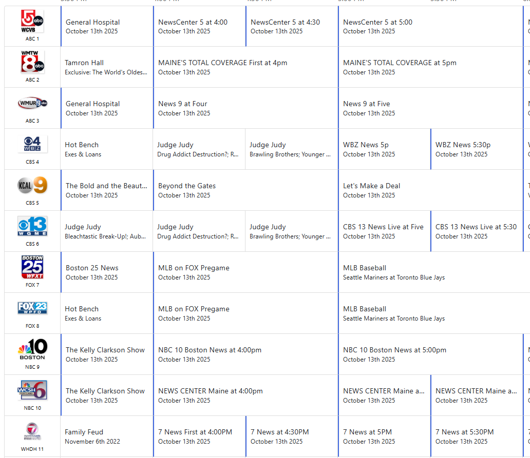

I'm struggling getting custom station logos pulled into Channels and was looking for some help. If I set the channel stations to be pulled in from an internet address, such as the below, I see the logo on the Channels web interface guide, but not the apps. I'm using an Nvidia Shield / Pixel phone combination.
Any ideas how I can customize the station logos so that they pull in to the apps too? I have a few difference CBS, ABC, Fox, NBC stations and having custom logos would help deifier which is which.

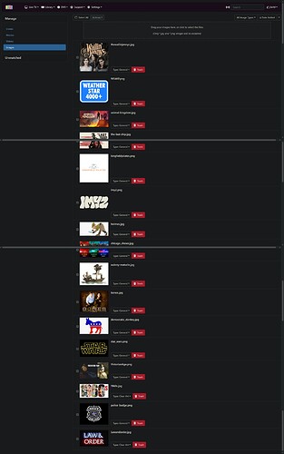

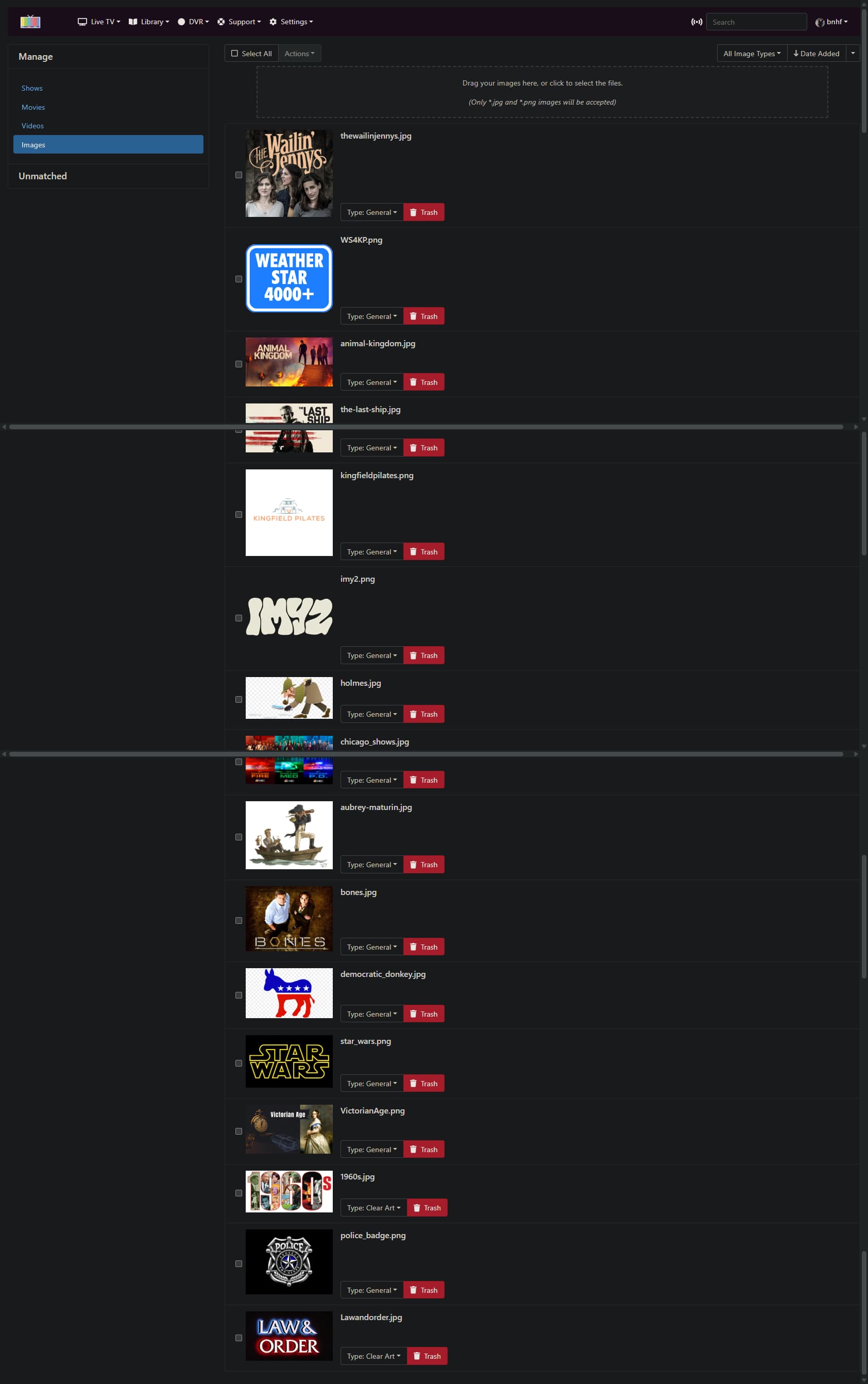

Have you tried adding them in DVR-Manage-Images? That's where I add mine; mostly for use with virtual channels and video groups in my case.

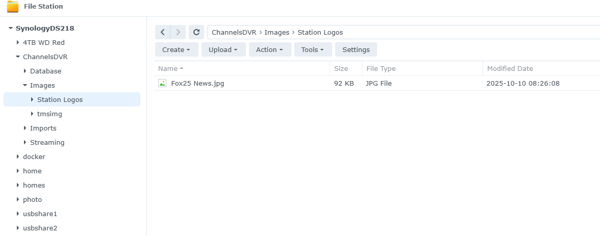

I tried creating a folder within the ChannelsDVR Images directory and placing station logos, but I don't know how to actually directly link to it.
No. In the WebUI under DVR-Manage-Images. I use them for virtual channels mostly though, not sure how they'd work for your situation:

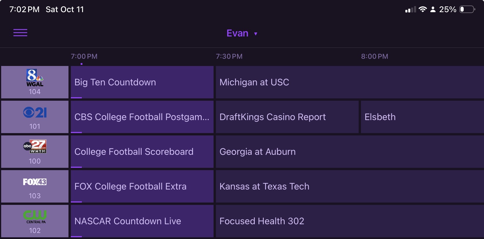

I just checked my iPad, and they appear to be working. I might be behind on an update to Playlist Manager, I’ll have to check that, and check the thread.
(Edit: I should add that my logos are hosted on an external web server, if I recall.)

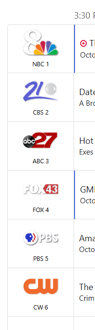

Another option to consider is: TV Logo Manager
Just used TV Logo Manager. That worked! I don't understand why, but it did.
Thanks for the suggestion!
Looks like we are in the same neck of the woods (Mechanicsburg). I don't use Playlist Manager but can say I really like TV Logo Manager (I used Threadfin as a middleman between my backend CDVR Server and the Front End Server that clients connect to):
I can finally distinguish which CBS, ABC, NBC or FOX I'm watching. Much cleaner.
