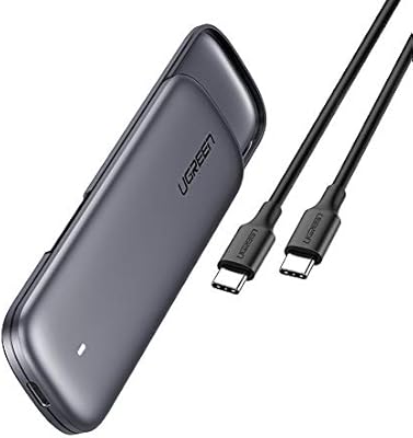

I've been running my Mac Mini M1 (8GB) with an external UGREEN NMVe enclosure with 1TB Intel 660p NMVe storage. It's powered solely by the USB-C port, and I have had no issues. I have many times been recording 3 streams, playing 1 stream, and even doing commercial detection on another stream simultaneously. Also seemed to be the most compact way to do this.
Link to enclosure I purchased is below:
That "UGREEN NMVe" looks like a nice setup and NMVe is capable of some excellent i/o speeds when internal, like 4 - 6 times faster (2500-3500 MBs) than most USB 3.x ports that are SATA based.
So, in my mind if using external SSD may as well go with possibly less expensive SATA SSD since USB 3.0 speeds may top out around 500MBs anyway (and maybe 1000MBs on USB 3.1) -- and internal SATA SSD also top out at about the same 500MBs as far as I know. For comparision, spinning disk may have i/o around 90-110 MBs.
But then, the NMVe SSD could always be repurposed for internal use on a compatible system at some later time if someone choose to do so.
