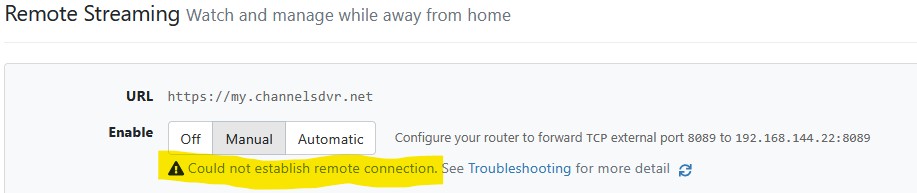

UniFi has the capability to port forward a port (8089) but limiting the external IPs that can access the server. I have mapped 2 of my friend's IPs to access my ChannelsDVR.
I don't want to make the setting as "Any" IP since that opens the port to everyone.
With the limited IPs for this port forward I keep getting:
"Could not connect to 655ac57xxxxx.u.channelsdvr.net. Check if the port is mapped" since the ChannelsDVR system does not get through to my server.
What is the IP/IPs that ChannelsDVR uses for the above so I can set it/them in my limited IP list?

It's the "Could not establish remote connection. See Troubleshooting for more detail" under the http://192.168.144.22:8089/admin/settings/general in my browser that I'm trying to establish a successful connection without having to open the port forward to the world.
Oh, that's from our health checks, and the IP it comes from isn't guaranteed to stay the same. You should just ignore the error. It's just fallout from your choice to limit IPS.

There is a health check that comes from our servers during initial auth. But its not any specific IP because it runs on a cloud service. But when you see that screen, there should be a link at the bottom to bypass and continue anyway.
