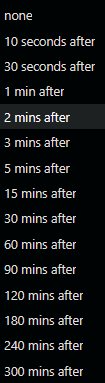

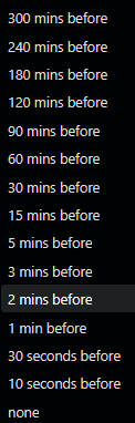

You could also pick an airing in the time slot you want and add pre and post padding to it. These padding options are presets you can pick from.
pre-pad post-pad

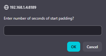

Creating a series pass will allow adding custom pre and post padding down to the second.
pass-custom-pre-pad
pass-custom-post-pad
