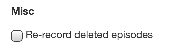

Or what I recommend is this checkbox on the advanced pass editor:
I like your recommendation - where do I find this option? - Never mind I found it.

I mentioned it several times:
It's under DVR > Passes > Edit Advanced
