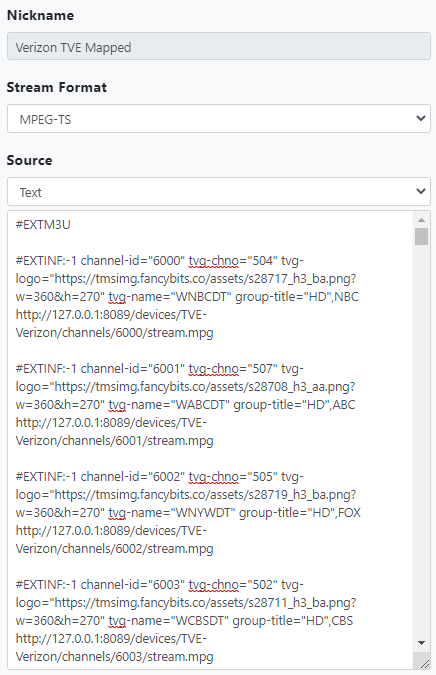

I have one Channels-DVR "Server" (main). I have 3 instances of Channels-DVR, one for each member of the household. All three user instances of Channels-DVR use m3u's to connect back to the the main server without issue.
Something else must be going on. Can you post one of the channel configurations from the m3u?
The only difference I see from how mine is setup is the missing format=ts on the URL:
http://x.x.x.x:8089/devices/ANY/channels/6030/stream.mpg?format=ts
The stream.mpg implies MPEG-TS, so the additional query string is unnecessary.
@CircusBrain, your playlist looks pretty similar to how I have my channel redirects handled, and don't notice any lags. So, I think this might be more hardware/network related than a configuration issue within Channels.
I also have this set up and don't experience any lagging.
