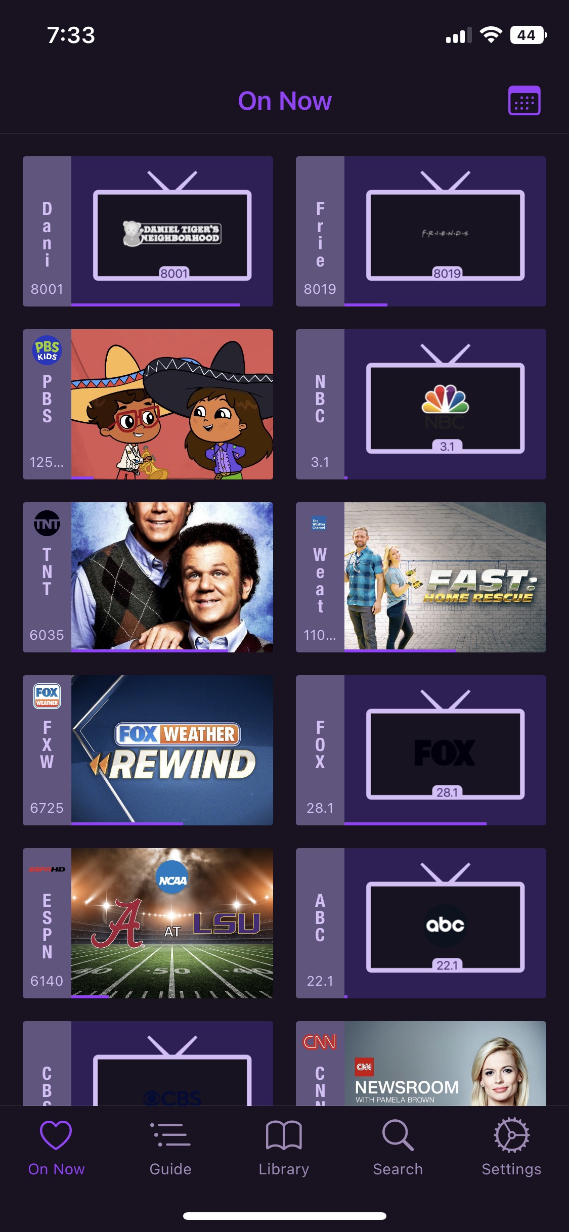

I have a couple of m3u lists that I have added and the xml for the guide. The guide for these channels works as it tells me the shows that are coming up and currently playing shows with episodes additionally the search function works in finding these shows. However It does not show any cover art. Plus the "On Now" only shows the channel Icon and not the cover art of the show that is playing. My DirectTV source works as it should (shows the TV Show/Movie cover art)

A good channel to look at would be 8001. All of my virtual channels show default logo in on now.
