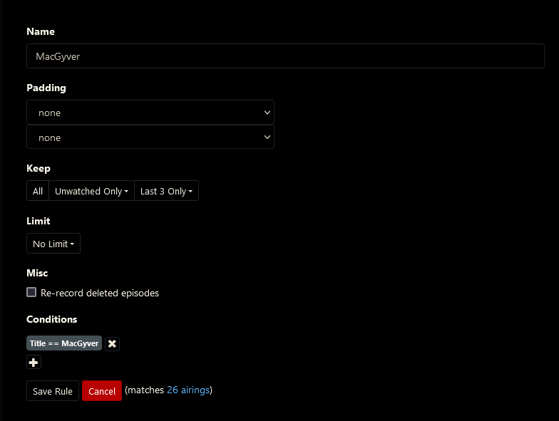

Try using a Title search pass.
Title ==
or
Title CONTAINS
The problem is different EPG providers use different SERIES ID's
Take MacGyver for example.
On Pluto source it's pluto/5f4724f38e4fda001a5c2626
On TVE or HDHR sources it's 183939
If your Pass uses a SERIES ID, it won't work on sources that don't use that type of SERIES ID.
If you change your pass to use Title == MacGyver instead of SeriesID == 183939 it will work for all sources.

The best way to fix these recordings would be to rename the files and move them into the Imports folder
Thanks - yeah, that's what I'm seeing as well. I also see their channels are named for the show.... so there's that. :slight_smile: Not a big deal - I think I'll avoid recording things from the Samsung source if I can help it, unless it's a one-off.
Thanks - that makes sense. I haven't played with custom filters and tags since that option came out some time back.... I didn't have too good a luck with it back then, and just haven't tried since. That seems like a good option.
It's the Advanced Pass view in the DVR web UI.
Under DVR>Passes
Select the dropdown to the right of the pass and choose Advanced.
More info on Advanced Passes here Advanced Passes - Channels Community
