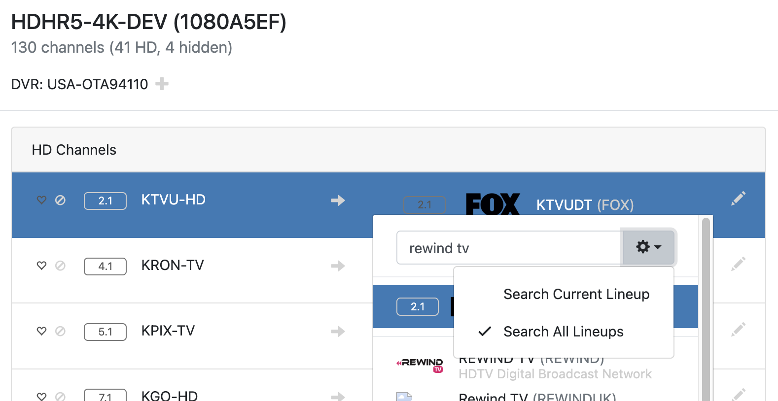

You can change the mappings on your DVR
Thanks that helps and I have hopefully matched all the channels that were missing or mapped incorrectly.
