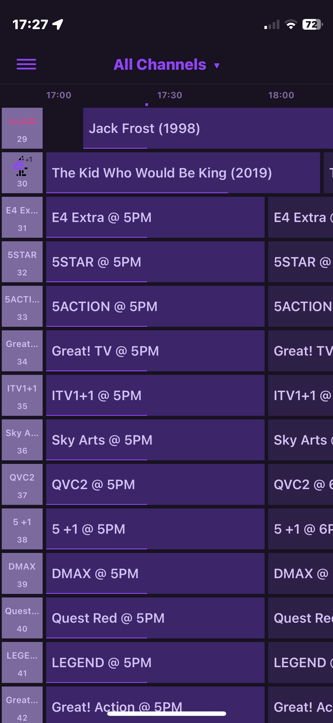

Whatever I do Channels only syncs data for the 1st 30channels (logo and TV Guide). I can manually search and match channels in manage lineup, but I don’t what to do this for 100+ channels. Channels then downloads TV guide data.
I’m assuming something must not be working quite right?
If I match all the channels manually will this info suddenly disappear in days/weeks/months time?
Example screenshots

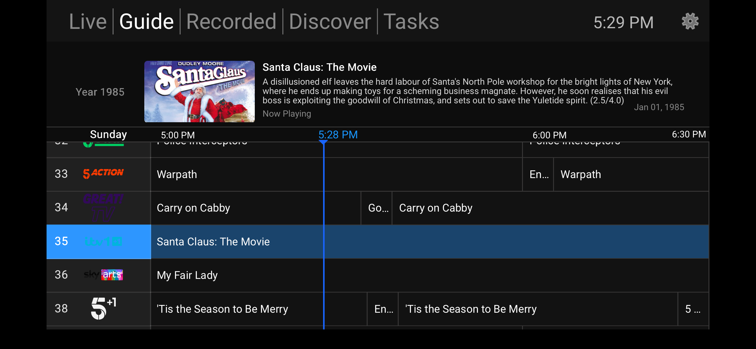

I have deleted provider and hit search on a local postcode. Then chose Freeview as the option, much more guide data is now downloading.
The TV guide stuff seems difficult to grasp as a noob, anywhere that explains how the whole TV Guide programming works?
Freeview is the correct selection for hdhomerun with aerial
