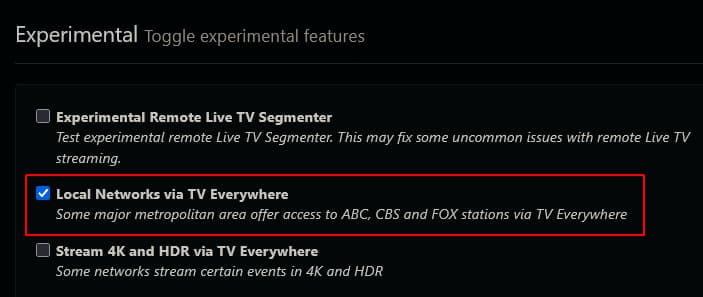

Are you toggling the TVE locals checkbox to rescan your TVE local channels?

Details for getting TVE ABC back.
I checked the ABC website and it appears to be a local feed. I couldn't really tell except for the logo of our local station appearing in the NCAA broadcast I was streaming, so I assume it is the local. I then toggled the TVE checkbox to force a rescan and that caused ABC to show up! Yay!
At first I didn't think it worked because long ago I had set the TVE ABC to "do not use". I didn't need two sources and the HDHomeRun source seemed like the better way to go.
I set the TVE source to favorite, redownloaded the guide for TVE, and I'm back in business.
