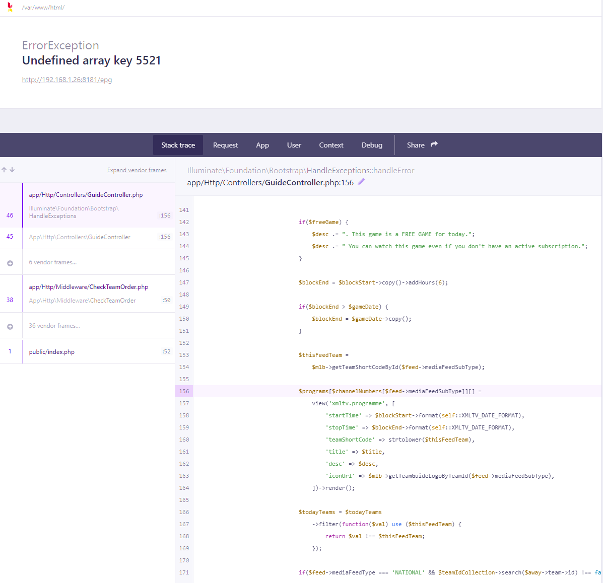

i know the season is almost over, but can anyone else load the EPG from the container in their browser and let me know if they get an error? i had one earlier today and i think i've fixed it, but i want to make sure it's not just an issue on my network before i go pushing more code...
I'm getting the error in php code. In GuideController.php line 173.
Same error for me.
cool. i mean, not cool...but i'll get a fix out for it for the last two days of the season anyway lol
just pushed 1.5.2 which fixes the guide issue mentioned above.
Just to confirm the fix. It loads now for me.
Thanks @crackers8199 !!

hey bud, so im getting this epg error with 1.5.2 . any ideas? thanks again for this.
channels-baseball
date stream content
2021-10-05 15:29:03 stdout 172.17.0.1 - - [05/Oct/2021:15:29:03 +0000] "GET /epg HTTP/1.1" 500 787946 "http://192.168.1.26:8181/" "Mozilla/5.0 (Windows NT 6.3; Win64; x64) AppleWebKit/537.36 (KHTML, like Gecko) Chrome/94.0.4606.61 Safari/537.36" "-" 1.015 1.015 . -
2021-10-05 15:29:03 stderr 2021/10/05 15:29:03 [warn] 11#11: *4074 an upstream response is buffered to a temporary file /tmp/fastcgi_temp/0000000005 while reading upstream, client: 172.17.0.1, server: _, request: "GET /epg HTTP/1.1", upstream: "fastcgi://127.0.0.1:9000", host: "192.168.1.26:8181", referrer: "http://192.168.1.26:8181/"
2021-10-05 15:29:00 stdout 172.17.0.1 - - [05/Oct/2021:15:29:00 +0000] "GET / HTTP/1.1" 200 476 "-" "Mozilla/5.0 (Windows NT 6.3; Win64; x64) AppleWebKit/537.36 (KHTML, like Gecko) Chrome/94.0.4606.61 Safari/537.36" "-" 0.969 0.970 . -
2021-10-05 08:56:50 stdout 172.17.0.1 - - [05/Oct/2021:08:56:50 +0000] "GET /epg HTTP/1.1" 500 777491 "-" "Mozilla/5.0 ChannelsDVR+XMLTV/1.0" "-" 1.187 1.028 . -
2021-10-05 08:56:50 stderr 2021/10/05 08:56:50 [warn] 12#12: *2534 an upstream response is buffered to a temporary file /tmp/fastcgi_temp/0000000004 while reading upstream, client: 172.17.0.1, server: _, request: "GET /epg HTTP/1.1", upstream: "fastcgi://127.0.0.1:9000", host: "192.168.1.26:8181"
