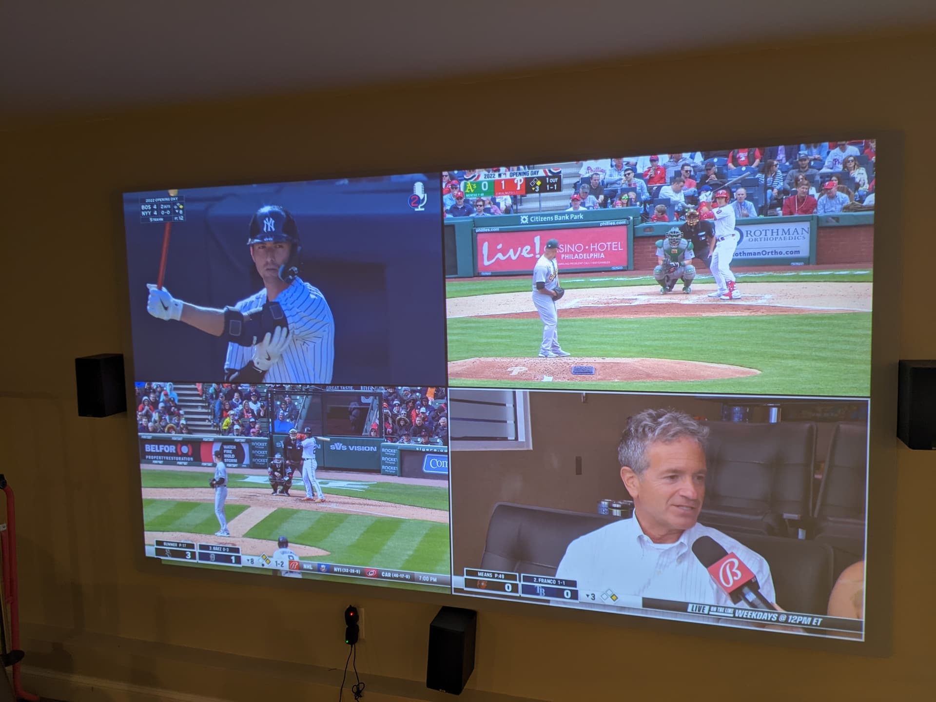

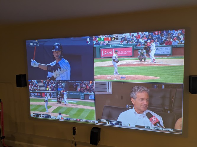

This works great! Especially with a projector!

is that on a pc or is there a channels client that can display multiple channels?

I can't speak for the person who posted this but I have used tivimate for Android to display multiple feeds at once. it can handle more than four at a time, too...

On AppleTV there are a few options: Surveil Stream, QuadStream, and CCTV Viewer, all work with streams from Channels DVR.

As others have mentioned, this is Tivimate running on an Nvidia Shield to a 120" projector screen. I export an epg and m3u for use in Tivimate. It works flawlessly. Great when there's multiple games on.
I use Channels DVR for one channel or to watch DVRd content and Tivimate when I want to watch a bunch of stuff live.

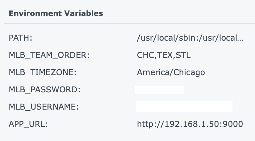

If you click on your container and select Details, what does your set of Environment Variables look like? Should look something like this:
I think that part (environment) is fine.
Issue might be setting those volumes, and the Ports. I need to do some reading to understand these. I completely new to docker. Thank you!
