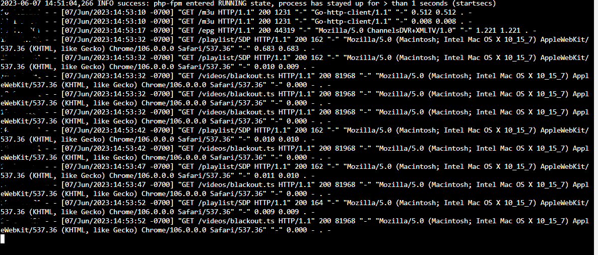

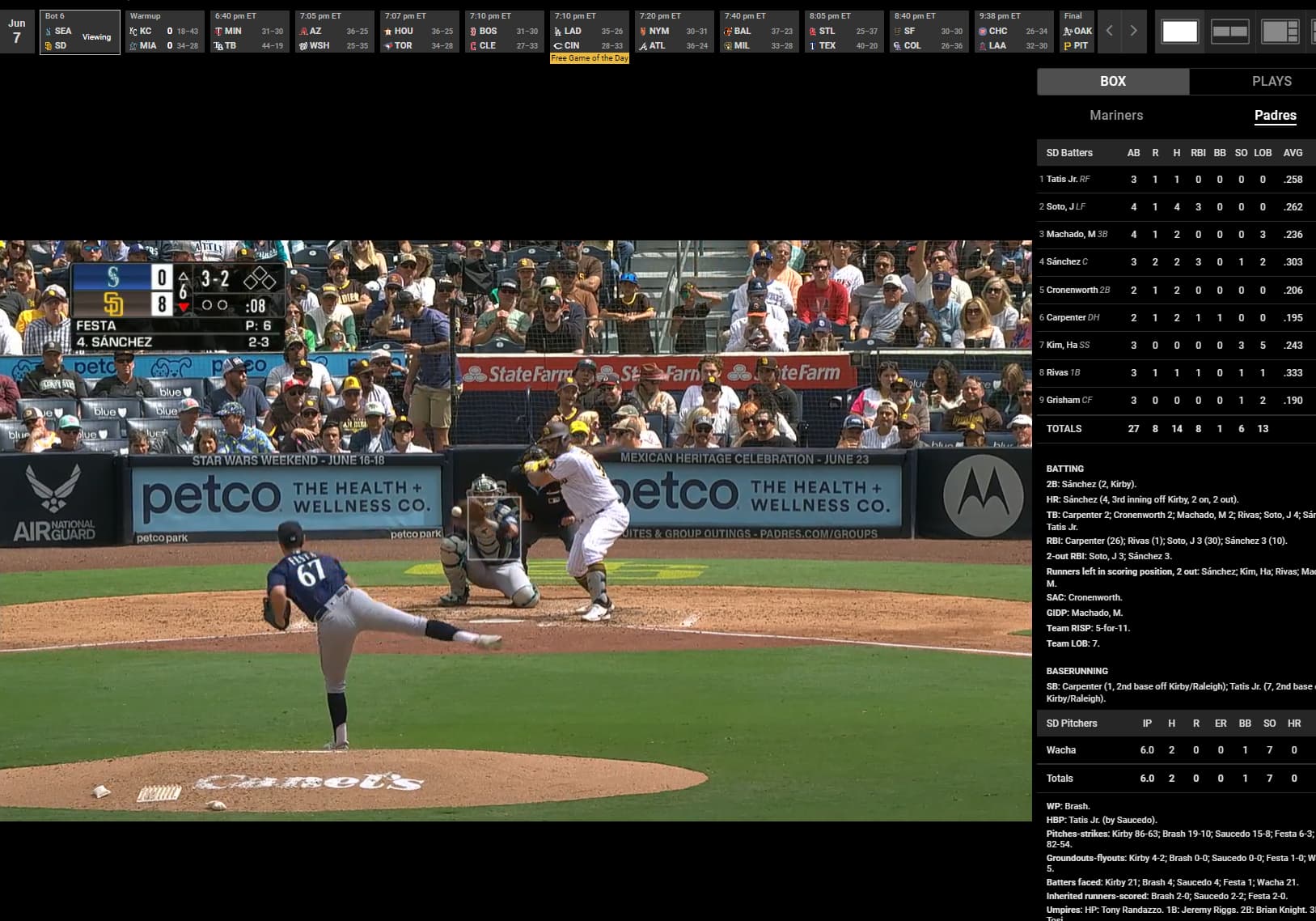

So how does this work now with the Padres? I can log into MLB.tv and watch the Padres games (I am local and have paid for local rights through MLB.tv) but cannot tune in via For Channels. I always get the Blackout restriction.
I have it as a Docker on my Unraid and have restarted it there. Also restarted channels server. Still pulling in Blackout. I pull it up in my phone via channels and it's Blackout. Pull up the MLB.tv app and it plays. What am I doing wrong? Do I need to recreate the container?
I set up E+ so it seems that the MLB.TV For channels is the issue or else I am missing something.
Just an FYI, I recreated the docker and the Custom Channel and same issue.

Do you have to go to a special page on mlb.tv or can you just click on the padres game like you would any other game?
I just click on the Padres game. I can get it on E+ but the MLB For Channels is not working.

if the docker container is telling you / channels that the game is blacked out, there's nothing i can do. i don't control that, it comes directly from the MLB API. the container grabs the stream URL from the API, and the API won't give you access to the stream if you're in a blackout zone.
it's not a matter of me changing the URL, it's a matter of MLB sending the correct URL and removing the blackout restrictions. if they say you're blacked out and they won't allow access to the stream, there's no way i can get around that.
as i've said time after time in this thread, i cannot and will not support bypassing blackout restrictions. if the E+ container can do it or wants to support it, that's up to them. i just hope they don't get API access to the streams shut down for all of us.
theoretically, if MLB has it set up correctly, it should just work. i only get the stream for a game when someone clicks on the channel to request it.
when a channel is opened, the container hits the MLB API and says "hey, is a game active?" if the answer is yes, then it goes back and says "okay, give me the stream so i can watch it." it's at this point where MLB looks at your connection and determines however they determine whether or not you're in a blackout region. if not, it gives you access to the stream. if you're in a blackout region, it tells you so and then channels loads the blackout message.
i would imagine MLB should have updated this when they took over the padres broadcasts, but i'm not in the SD market so i have no way of determining that for certain. i'm already in the clear based on my zip code.
