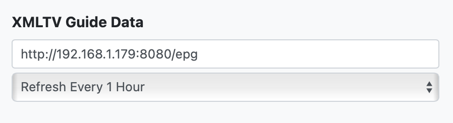

The issue seem to be that the XMLTV Guide Data field keeps re-populating itself. How can I stop that?

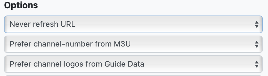

- I had to go to 'Edit Settings' (for the mlb source) and do the following:
- clear the URL under XMLTV Guide Data
- set your 'options' to look like this:
- Click 'Save'

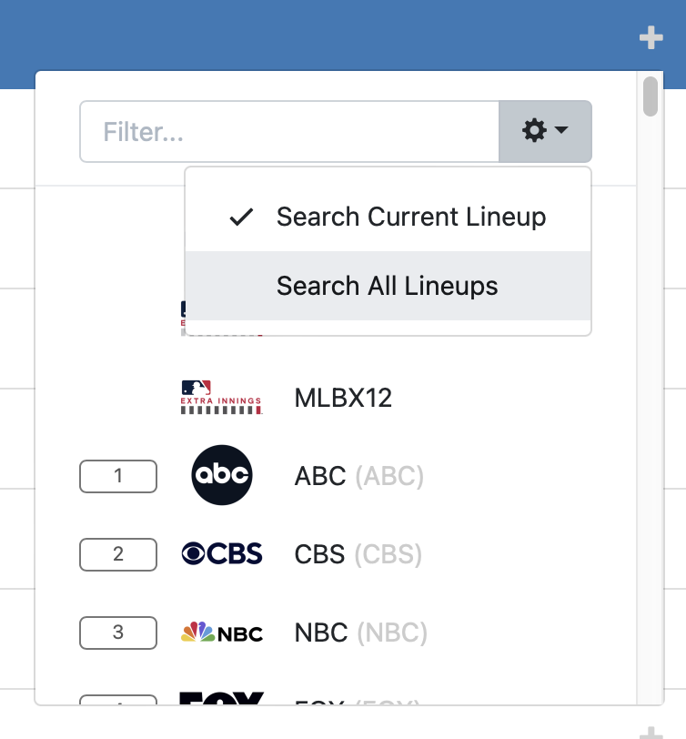

- click 'Manage Lineup' (for the mlb source)
- click the 'plus' next to the team you want guide data for and choose 'Search All Lineups'
- type the team name in the search box and choose the 'Extra Innings' source
- close the window
- redownload guide data
- Search for your team, and add your team pass as per usual!

NOTE: Never click on 'reload m3u' or it will pull the XMLTV Guide Data from the EPG url again. If you do start getting the 'old' guide data again, just clear the XMLTV Guide Data URL, and Save, and 'redownload guide data' again, and you should be good to go.
