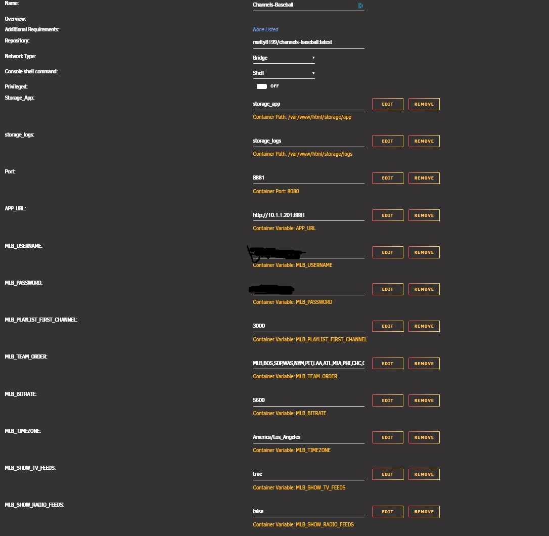

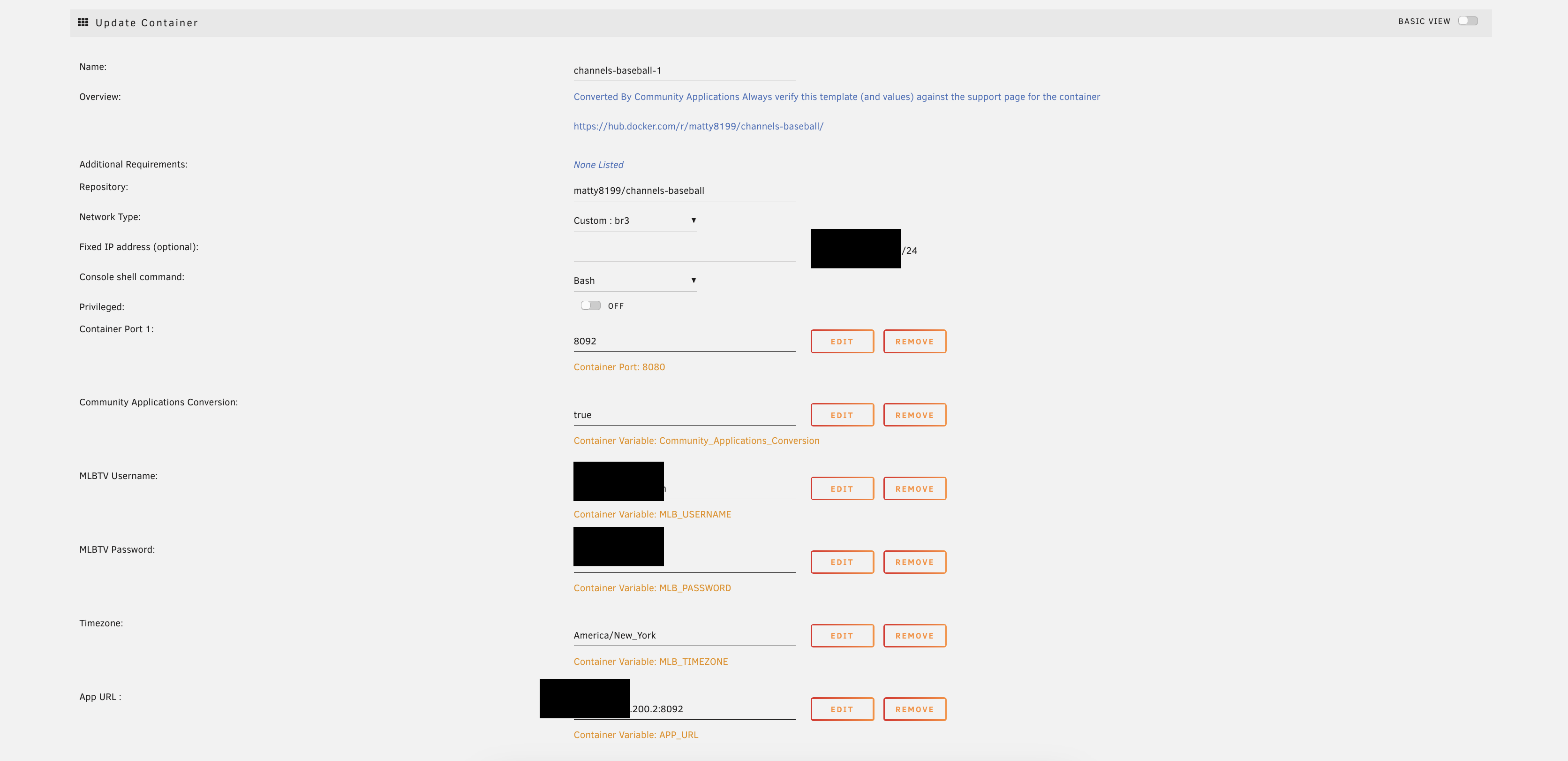

@crackers8199 I am a bit embarrassed that I can't seem to run the command in Unraid. I've attached what I get when I load the console on the Docker within Unraid. I tried to run it within a Docker Instance of Portainer too, but am getting no results.

Did you put in your storage paths? When I made the docker, I made it myself manually as the translation for Unraid didn't seem to work correctly.

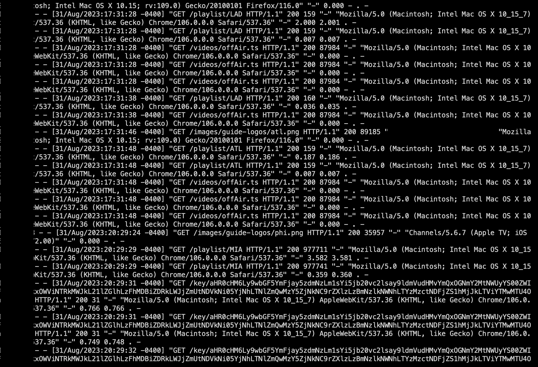

With Spring Training right around the corner, I checked on my MLB channels and see that I'm getting an error and none of the channels are showing up anymore. I'm trying to figure out if there is something that has broken on my end, or is this not working for anyone?
I am seeing this error in the log:
2024/02/14 15:01:10 [error] 12#12: *8532 upstream timed out (110: Operation timed out) while reading response header from upstream, client: 192.168.1.250, server: _, request: "GET /epg HTTP/1.1", upstream: "fastcgi://127.0.0.1:9000", host: "192.168.1.250:8080"
Hi there,
What are you seeing in the MLB app?
I'm guessing they may have changed the streaming.
We will need to see what happens once the streaming provier starts working with the feeds.
