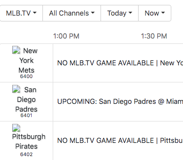

they dont work in the webui. i think its because the webui is lookding for https images and your container only serves them via http.
really? mine do. i use it all the time to watch games from my tesla while i'm supercharging or waiting for take out...
Screen Shot 2021-07-22 at 1.11.35 PM
right click on the missing image and it goes to https:
take the https away, and it appears:
strange. when i go out for lunch i'll take a picture from my car...it works just fine in my tesla.

I have the same issue on the webui and have also narrowed that down to the https as accessing using http also gives me the icon. Not sure if that is browser specific though and I at least still get the channel names so I was not too worried.
However, I think the icon issue, at least for me, has to do with using the internal ip address. When I am on the local network the icons and channel names do show up in the guide on the channels app. When I am away they do not. I believe Channels is setup to fetch guide images in the app from the internet independently rather than pulling them from the server. So when I am away from home and the app is told to pull the image and channel name from an internal ip address at a different location it cannot access such. It does get guide data but instead of the channel name and icon I just get the channel number. To test this theory if I change the ip address in the container to my external WAN IP I can pull the channel icons and names from any location which as stated bring up a whole additional set of issues that there is no need to dive into.
Maybe the https issue could be the cause of both the webui and external guide issues I do not know. Again this is probably the least pressing issue you have but I am glad to see I am not the only one experiencing it at least.
