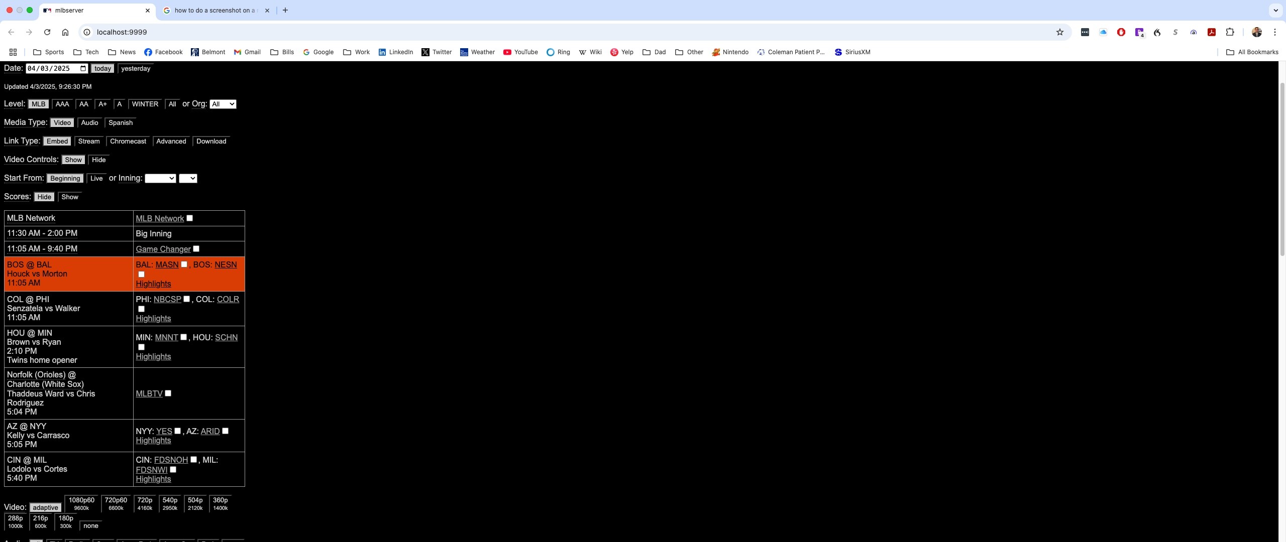

When I follow the link to the MLB TV server from the container, it has a list of different settings. The video is set to adaptive, but it has selections for 1080P all the way down to a low picture quality. I click on 1080P but then every time I go back to it it’s changed back to adaptive.
See the video
settings at the bottom of the page
Those buttons are just for watching within the mlbserver web interface. They don’t have any effect on the channels.m3u streams.
