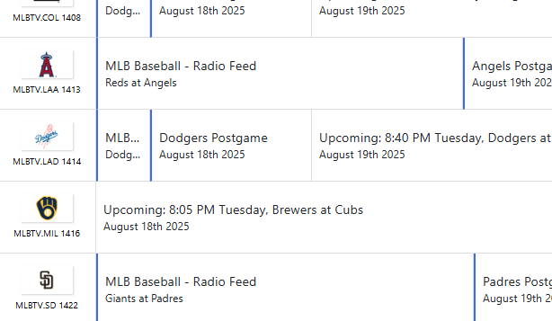

@tonywagner This is awesome. Is there any way that an argument could be passed to the guide.xml so that each entry description could append "- Radio Feed" or something similar? I have both in my guide and have to remember that mlb channels XX-YY are radio and AA-BB are TV audio
Like:
MLB Baseball - Radio Feed
Giants at Padres
You do awesome work and I appreciate it!
Edit, I actually just asked chatgpt to create a tiny reverse-proxy in front of mlbserver that rewrites the XML on the fly so every <title lang="en">MLB Baseball</title> becomes <title lang="en">MLB Baseball - Radio Feed</title>. I'm sure I'm a corner case so this works out just fine for me :slight_smile:

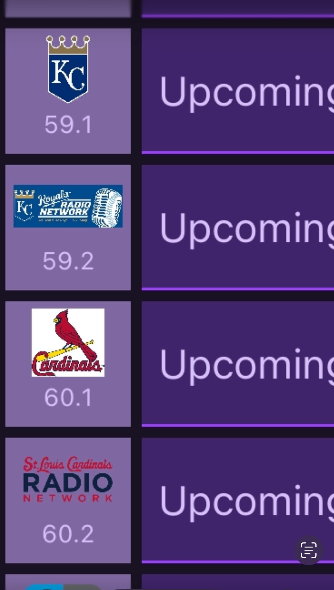

I just create a sub channel with its own radio logo.
That's cool. Is there a good source for all the radio logos?
Unfortunately not that I could find. I basically just googled for each individual team’s image.
Thats awesome. Can you export your m3u so incan steam them? :slight_smile:
This won’t be much help since I only did the 2 teams the family watches.
#EXTINF:-1 CUID="ROYALSRADIO" channelID="ROYALSRADIO" tvg-num="59.2" tvg-chno="59.2" tvg-logo="https://img.mlbstatic.com/mlb-images/image/upload/t_5x2/t_w2208/mlb/cktlfnkygzvwsftoeefa.jpg" group-title="MLBTV",RoyalsRadio
http://192.168.1.202:9999/stream.m3u8?team=KC&mediaType=Video&resolution=best&audio_track=radio
#EXTINF:-1 CUID="CARDINALSRADIO" channelID="CARDINALSRADIO" tvg-num="60.2" tvg-chno="60.2" tvg-logo="https://mmo.aiircdn.com/512/61d888e615fb3.png" group-title="MLB",Cardinals
http://192.168.1.202:9999/stream.m3u8?team=STL&mediaType=Video&resolution=best&audio_track=radio
I know you are looking for a complete m3u with all of the teams logos but I posted this as a sample for other people.
