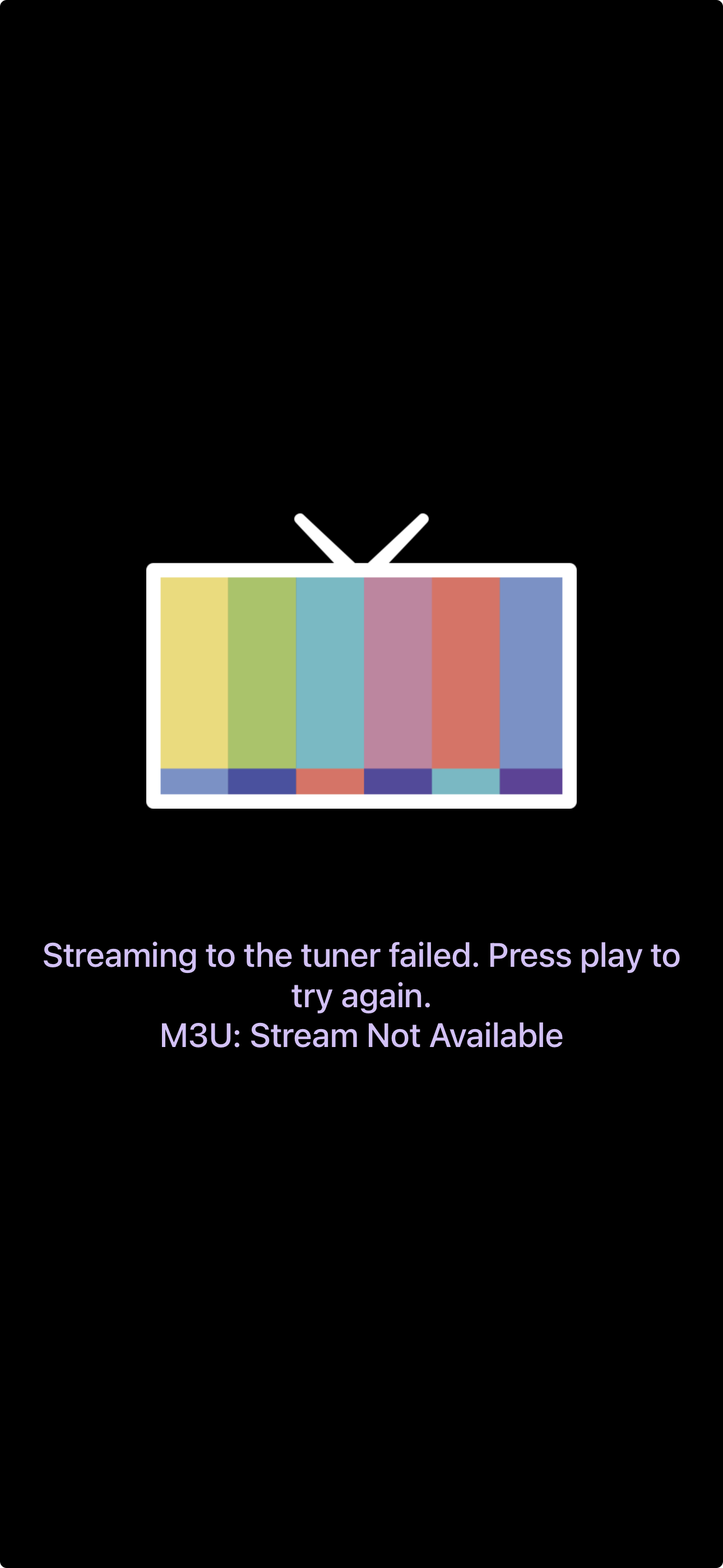

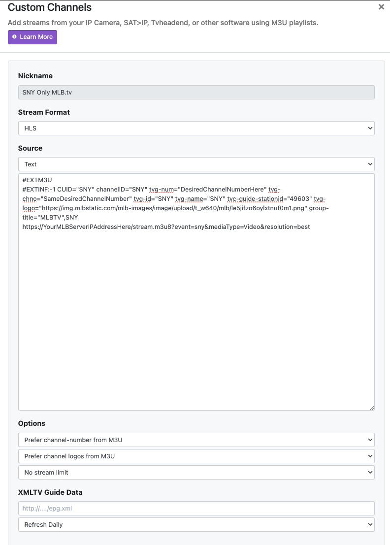

hold on. I had to clear out the XML guide data field. Once I did that, the guide updated. Now the guide looks good and I scheduled a recording for a mets game happening right now. But - the stream is no longer working, Getting this error
try the url in the m3u as http:// instead of https:// ?
Good catch. That's my bad on the original instructions. I was using a reverse proxy for mine and didn't even think about that.
@rss7 do what @KineticMan said and it should work.
SUCCESS! Thanks to you both. Love it. Is this pretty much set it and forget it, or does a custom MLB channel require much maintenance?

I turned on scan mode to confirm my testing and all I’m seeing is this on channels
I confirmed my m3u link and it’s hls-stream works fine in vlc
Any idea
