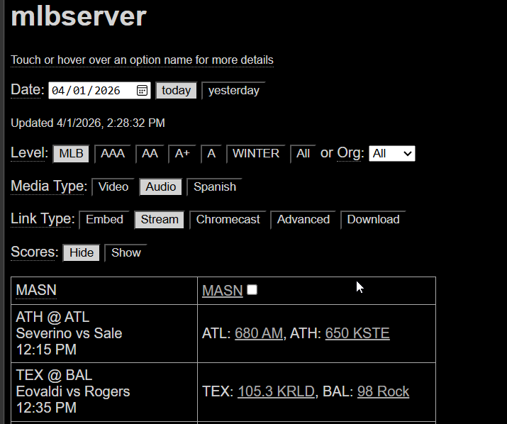

strange question i know - but tony is there a clean way to pull just a team audio stream - trying to set it up so my son can listen to the games on his yoto - it accepts like radio style links but the wbal for orioles is impossible to get that way
Like i know i have this
But i want to make it a permanent link
Yes! It's the same format as the video links in the M3U, just change the "streamType" to "Audio". So for the Orioles radio stream:
http://10.1.1.136:9999/stream.m3u8?team=BAL&mediaType=Audio
You could make it a web page too:
http://10.1.1.136:9999/embed.html?team=BAL&mediaType=Audio

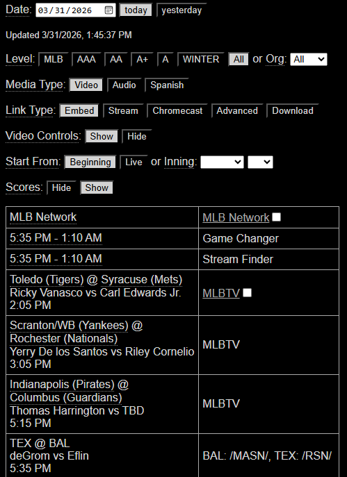

New version 2026.4.1-2 just pushed. Should fix the Big Inning schedule scrape problem reported here, adds support for multiple Big Inning events in a single day, and fixes the odd port undefined error mentioned earlier.
It also adds an experimental feature: a MPEGTS output format where you can adjust the audio sync with a URL parameter. Unfortunately MLB may not be giving us streams with a consistent sync differential right now (it grows in an nonlinear fashion throughout the game), so this may not be too useful at the moment.
But for example, the following URL should play the KC game, with the radio audio, adding 2.3 seconds of padding to the audio to attempt to sync it with the video:
http://192.168.1.202:9999/stream.ts?team=KC&audio_track=radio&sync=2.3

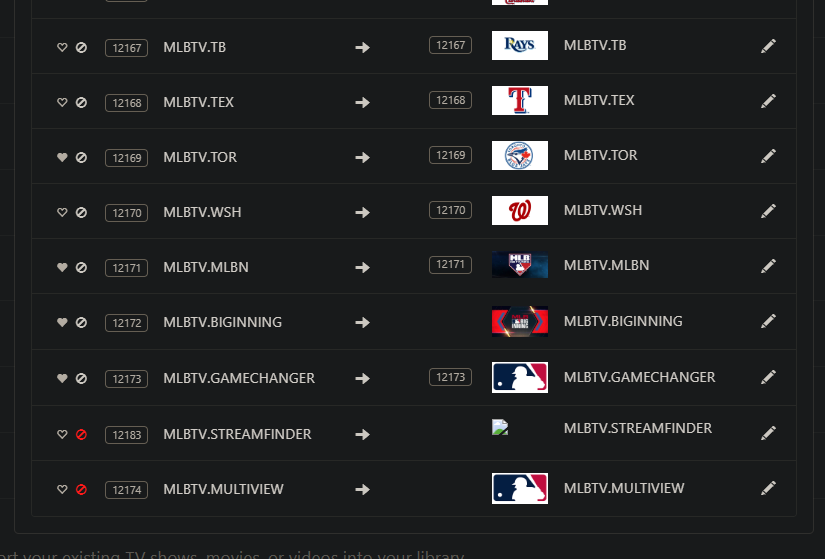

mlbserver seems to not be serving channels today... the "channels.m3u?mediaType=Video&resolution=best" endpoint seems to only serve big inning, game changer, stream finder, and multiview.
edit - ignore the include teams that was something i was playing with. fixed the correct m3u
all good now
