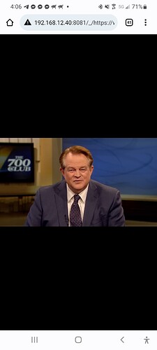

Don't worry about the shield and channels web access etc. Simplify this as much as possible. Docker is running on your computer. So use that url (the example I gave you with the 192 address) on another computer, laptop, phone web browser (on same network as the server) etc. If it works then you need to move on to the channels config but let's make sure it works in general
I just pasted my link in my mobile chrome browser and a play button appeared, clicked it and I had the stream
My ports are different so don't let the 8081 confuse you...

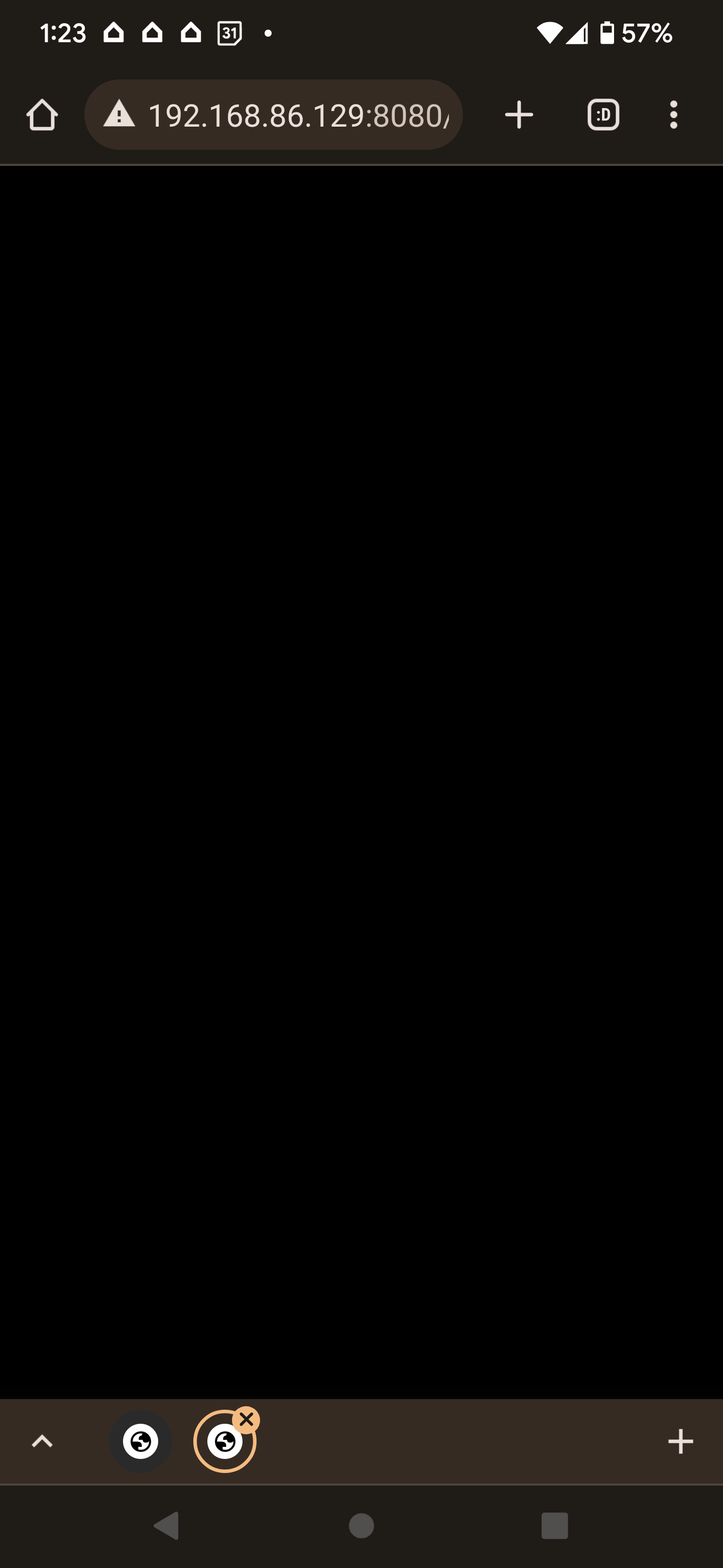

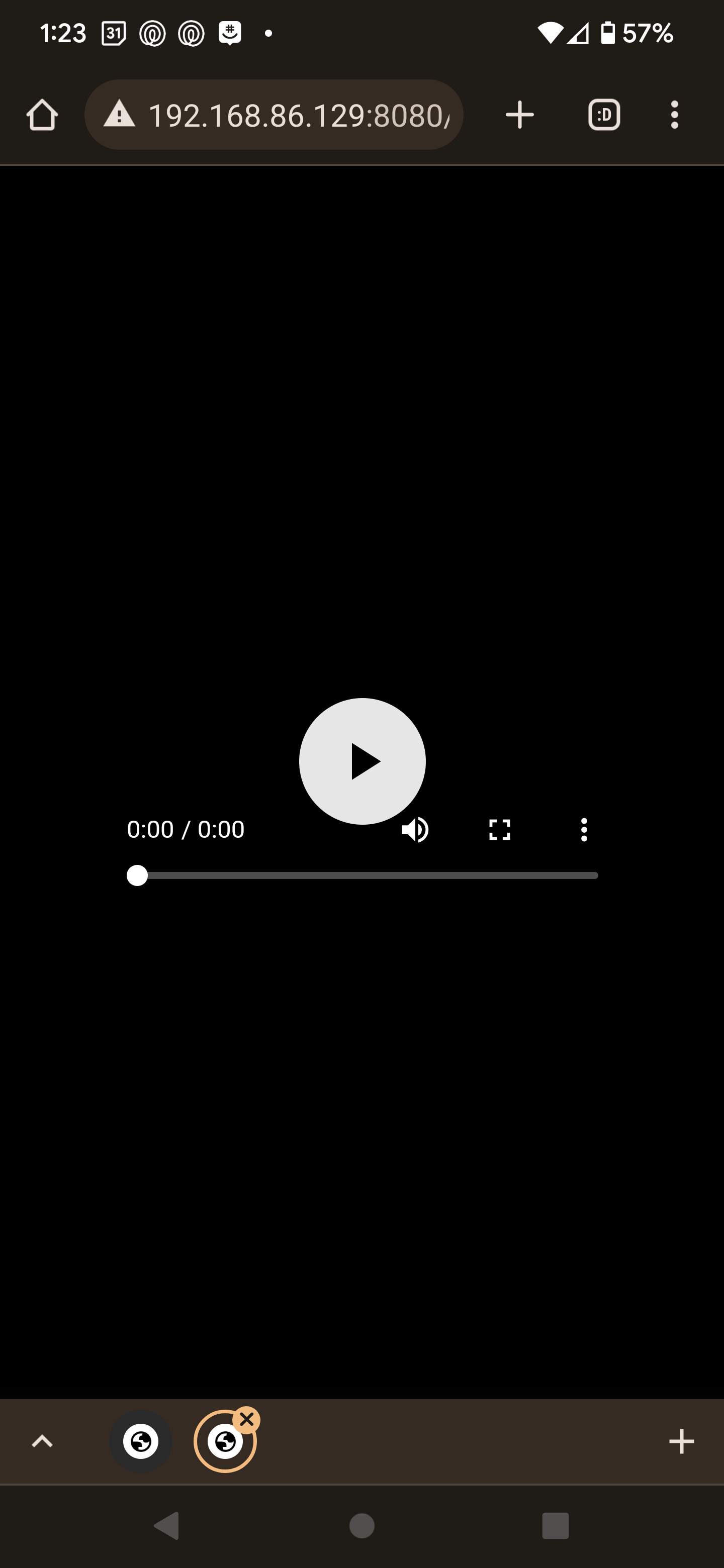

When putting the link into a browser I get a video screen with a play button and when I press play I get a black screen (no video)
You might have to head over to github and see if you can get help on the hlstube front. Docker for windows is a different animal than docker for Linux which is what I use. So I'm kind of at the end of my road for you unfortunately. I think that network wise you are reaching the server because otherwise you would have gotten page cannot be displayed instead of the play button. Could you try on a different computer and not a phone browser? Beyond that someone with Windows docker experience would have to chime in here (or the github hlstube forum)
