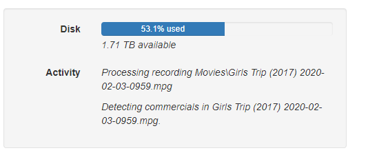

I have a recently recorded movie that has been stuck on the "Processing recording Movies" and "Detecting Commercials" for a few hours. I've restarted the Windows computer Channels is running on, but it just continues to try and process the movie after the restart. Most of my other comskip tasks take 20 - 25 minutes per movie. All 4 cores of my Intel i5 are running at around 40-45% utilization, so it appears something is trying to run.
I'm currently on build 2020.02.03.1850. I've tried re-detecting commercials, but nothing seems to work. Is there some reason why this movie would take so much longer than other similar length movies? Not sure how to fix it.

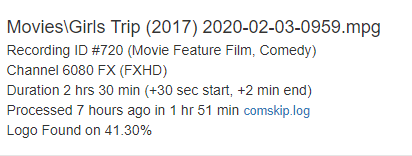

1hou51mins
Something was definitely weird though. Processed 7 hours ago, and took 1 hr and 51 minutes.
