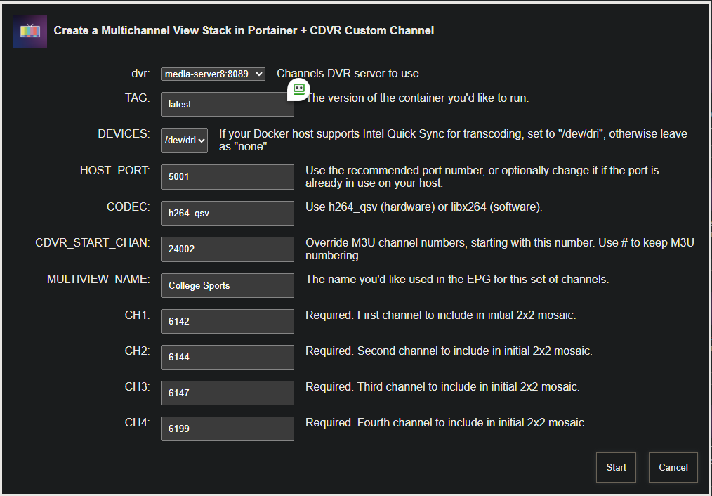

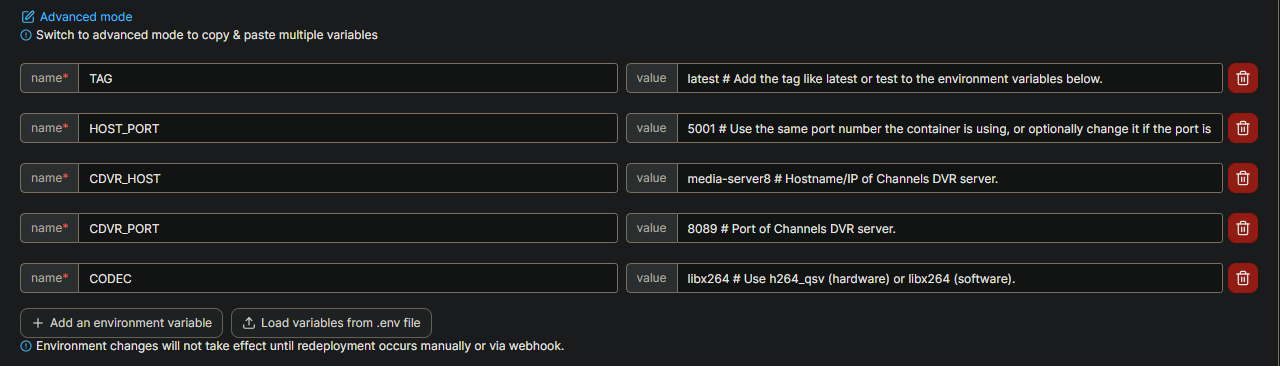

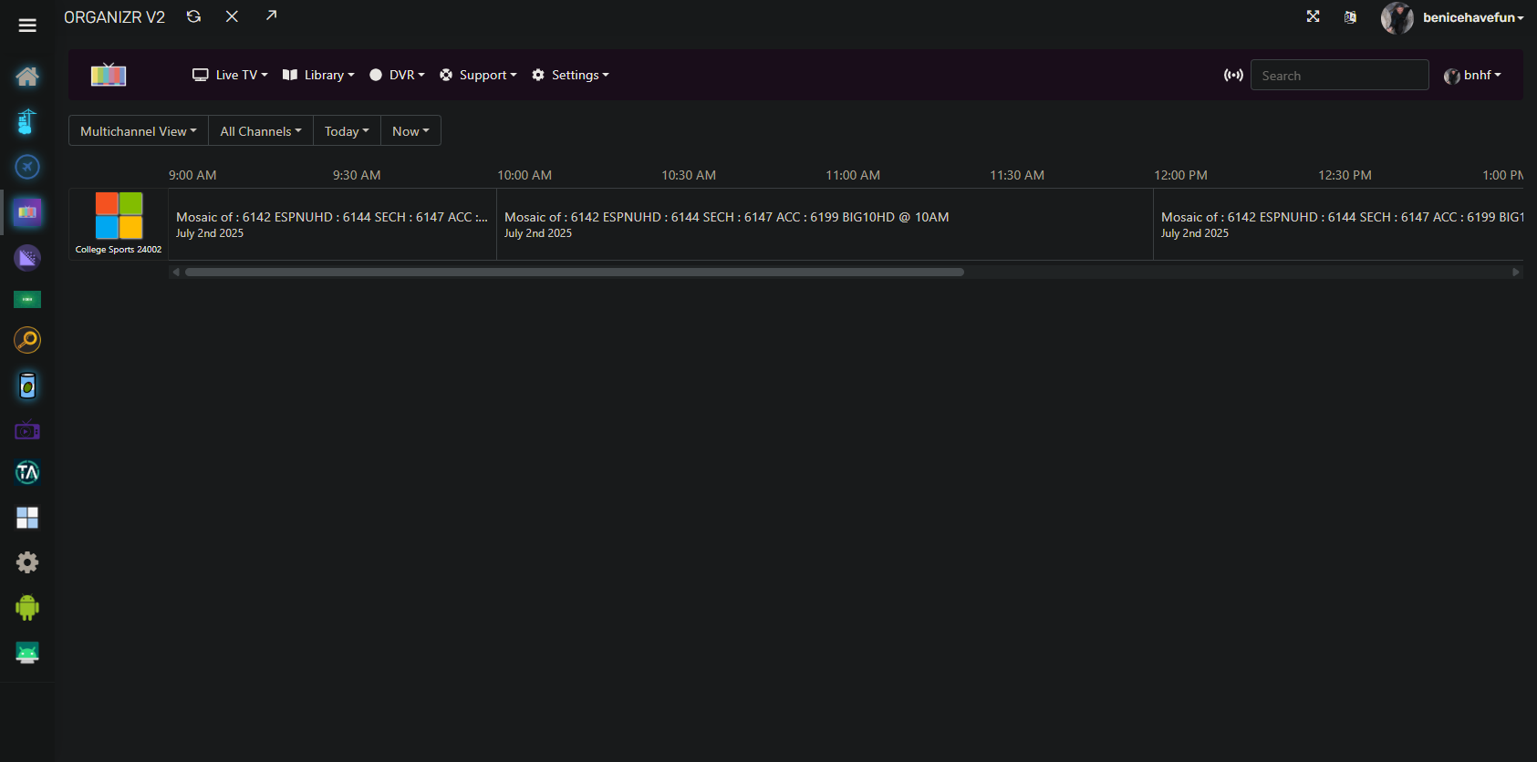

I've pushed an update, bnhf/olivetin:latest (aka bnhf/olivetin:2025.07.03), primarily aimed at improving the initial Custom Channel setup for this project in CDVR-Sources -- when spun-up through Project One-Click.
For example, this set of values:
adds a Multichannel View stack to Portainer, and creates and initial Custom Channel Source M3U:
with EPG data that looks like this:

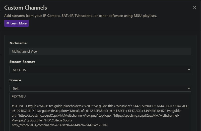

Got this working great. Thank you for all of your help! Can I set up multiple of these on different channel numbers? If so, how do I do that? I'm trying to have at least college football, MLB and college basketball.
You can. Edit Multichannel View under CDVR-Sources, and follow the structure shown there for the M3U.
Copy and paste the first entry to create a second, then change the tvg-id (add a 2, 3, etc after the MCH), modify the tvc-guide-title and tvc-guide-description to reflect the new mosaic of channels, change the name from College Sports to whatever, and modify the values in the URL with the new values you want for the 4 channels to combine.
Here's and example of what the first entry looks like on my system.
#EXTM3U
#EXTINF:-1 tvg-id="MCH" tvc-guide-placeholders="7200" tvc-guide-title="Mosaic of : 6142 ESPNUHD : 6144 SECH : 6147 ACC : 6199 BIG10HD " tvc-guide-description="Mosaic of : 6142 ESPNUHD : 6144 SECH : 6147 ACC : 6199 BIG10HD " tvc-guide-art="https://i.postimg.cc/pdCcpxMM/Multichannel-View.png" tvg-logo="https://i.postimg.cc/pdCcpxMM/Multichannel-View.png" group-title="HD",College Sports
http://htpc6:5001/combine?ch=6142&ch=6144&ch=6147&ch=6199
After you've added your new entry, save and then use the dropdown in the list of sources to reload the M3U.
Works perfectly! Thank you.

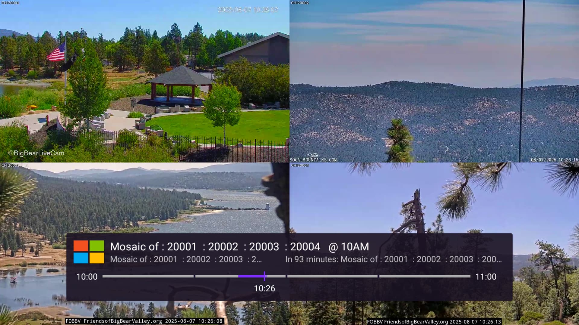

I have installed Multichannel view through One-click. It is nearly working. The container is running on a Synology DS920+ which has a Intel Celeron J4125 quad-core processor which is capable of Intel Quicksync.
I have enabled the hardware acceleration lines in the stack/container, and am using h26_qsv for the codec.
I am getting some buffering where the pictures pause and the timeline pops up across the bottom of the screen, showing the spinning icon. It eventually catches up. But, buffers every few seconds.
The four channels are live webcams on YouTube, imported to Channels DVR using "Streaming Library Manager for Channels".

I can say this... the Mosaic seems to be playing much better since I enabled hardware acceleration. Using libx264 software codec, it would scarcely load or play the channel. With h264_qsv codec, it will play for a few minutes at a time without problem. Then, it begins "buffering" and falls behind on the timeline. It will pause several times, over and over. Then, will play fine for a while. Though, never quite catching up on the timeline.
Right now, it has been playing for an hour or so, and is about 2-3 minutes behind...
It sounds like it's working, but being able to confirm would be nice. Maybe @chDVRuser knows something about install regular Linux packages from the command line on Synology?
Something tells me these webcam streams might be a tricky test. Have you tried choosing 4x TVE streams? It'd be interesting to know how those appear to work. Also, you can try the h264_vaapi codec to see if that makes any difference.
This won't play at all... Connection Lost. The h264_qsv codec seems to work the best.
I'm happy to try 4x TVE streams. I'll try to set up a new mosaic using your instructions from back a few posts earlier today.
