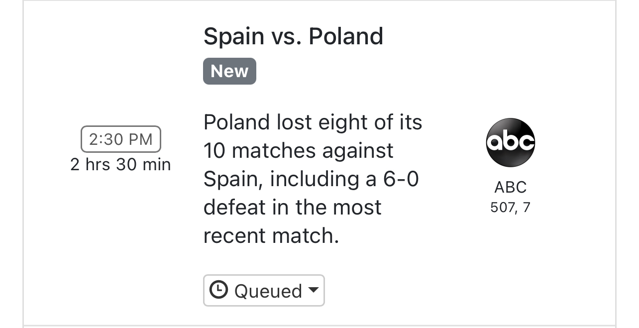

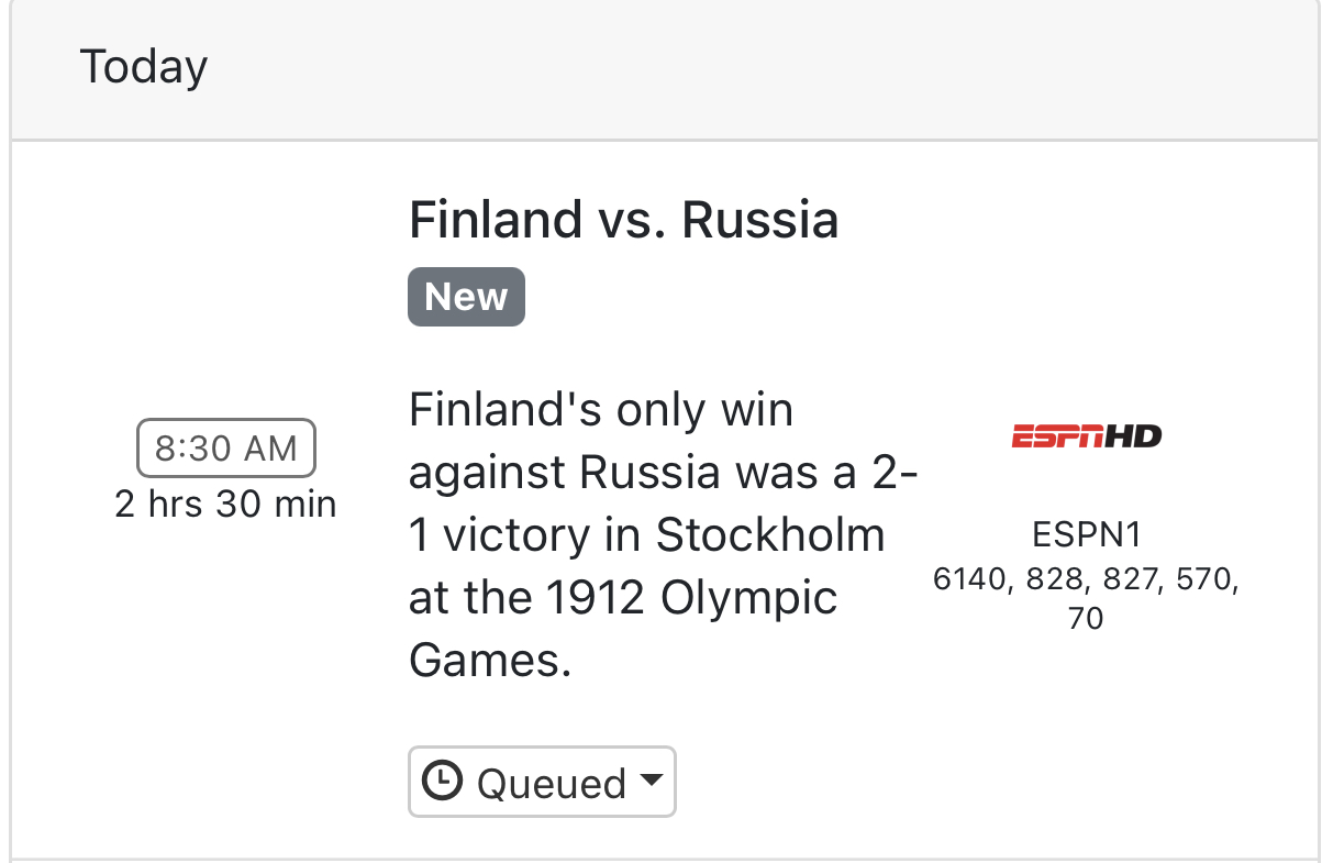

I have the same issue or question. I have setup Passes to record all the games for the 2020 UEFA European Championship. However, channels found multiple channel numbers for the same channel. In my example most of the games are on ESPN HD and In my area ESPN HD is on channel 570 but Channels recorded the game on different channel which is 827 and the game wasn’t being aired on 827 therefore it never recorded the game as desired. I would like to be able to tell channels for example only record on specific channels for example 1and 2 instead of channels picking on it own which channel to record on. I hope that makes sense. I have also attached a screenshot as an example. Thanks.
Find the pass under DVR > Passes and click edit there and you can set the channel number
Well the issue is the game is on multiple channels (ESPNNews 572, and ABC 507) not ESPN HD only, hence why I want to be able to set multiple channels not only one.
Make it an advanced pass with multiple channels in INCLUDES: Advanced Passes: Multiple CONTAINS/EXCLUDES (prerelease)
