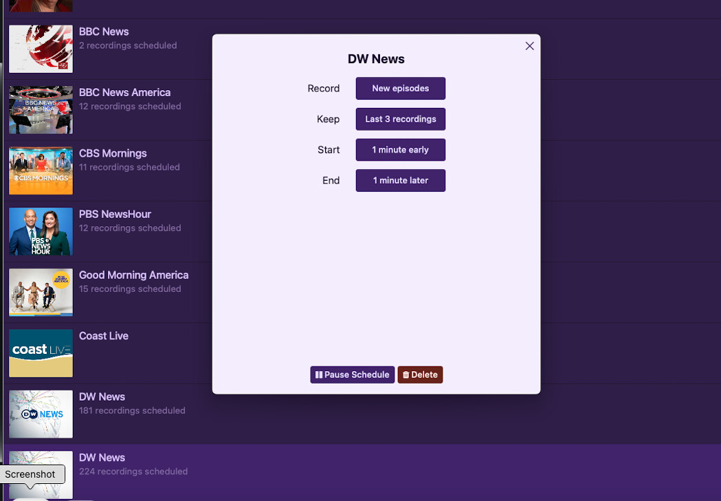

The MAC app has the same issue. I created 1 pass and wound up with 2 passes and hundreds of future scheduled recordings. And, there's no way to edit the pass to add a specific time or channel.

The show your'e attempting to record has bad guide data. This is different from all other shows, which record fine, which you'll see in your own recordings.
While it would be nice to have more options for creating passes in the client apps, this has nothing to do with the problem you're experiencing. The problem is because this specific show has bad guide data.
